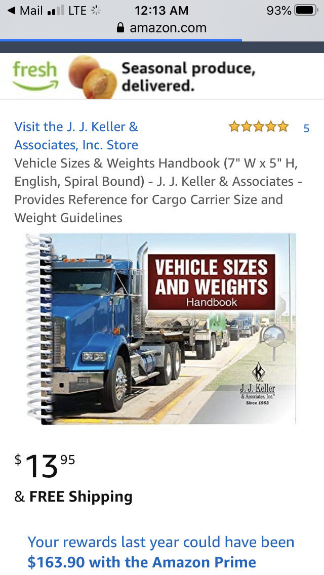

    0B78F51D-F5EA-4344-A809-E81E43A2AFE6.jpeg best book of all times. i also got a card that shows what brand and year trailer to set holes. i needed book the other day in fl. i ran 15th hole and 41,000 on trailer tandems. these two things saved my ### super fast. i turned too fl. it showed fl let you have 44,000 on a set but 80k and under

    Where can a guy get those?
    truckdriver31 Thanks this.
  7. truckdriver31
    5,483
    6,032
    Sep 18, 2013
    the book i guess online or store. the card is company made info. they also gave me the book
