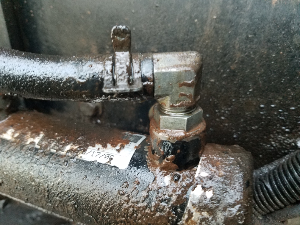

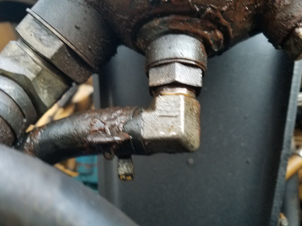

    I snapped a few pics of the fittings. They seep oil where the elbow screws into that adapter.
    Its a weird sort of fitting and somewhere inside there is a nylon washer that gets really flattened out.

    Are the lines loose that you can move them back and forth with your hand?
    If that's the case you have to tighten the nut where it looks like there's the washer underneath of it. That sets the position of the hose and you tighten it.

    Just what it looks to me, is not the fittings. So seeing you lost the oil filler cap the other day, I would get a new cap then an engine wash first before messing around with the fittings. See what actually leaks and what doesn't.
    It looks like you have oil (from the missing cap) all over the place and it condensed on those fittings and around them because of the amount of humidity and heat.
    These fittings rarly leak if at all, they are called SAE O-ring pressure fittings and are made to last a long time and work under high pressure which the reserve may have two or three psi at best.. If they loosen up, then tighten the nut up and that it is.

    No they are tight as I can get them. I took one apart and put an O-ring inside it where there was a nylon washer. It didn't leak for a couple days but then started back oozing oil again. They are all leaking just enough to make a dust trap that leaves a mess.

    The fittings were leaking way before the oil cap incident. They leak just enough to cause a mess. I hardly ever have to add oil to the PS reservoir.

    When I put the new engine in my truck I had to use a different power steering pump so I had to replace a lot of the fittings. Mine had rubber O-rings.
    If it were me, I would make sure that you know what lines go where and I would just take all the lines off and take it to your local hydraulic shop. I suspect the o rings that go on there are probably special o rings made just for that.
    If they tell you that you need to change the fittings or that you have to have hoses made because you need new fittings just have them made. There is only three and you already have it apart. But get reinforced hoses if you do that for all of it even the non pressure side.
    Any decent shop that makes up hydraulic hoses can help you to stop those leaks. Just make sure you clean those hoses up some and don't bring an oil leak dripping mess into their shop.
