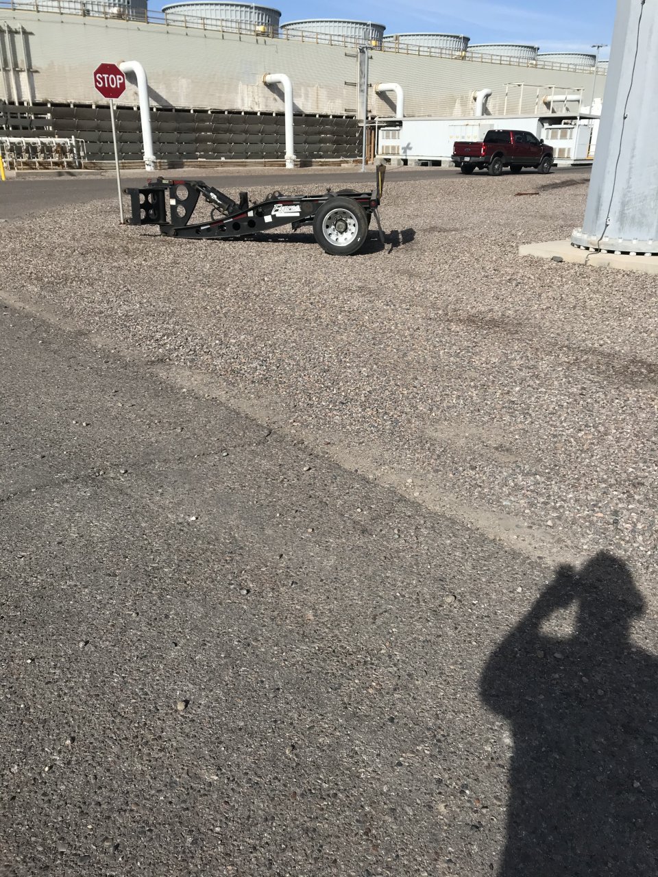

    spreader bar goes from the trailer to an axle or axles. Usually referring to an east coast trailer where the spreader bar attaches to the back of the trailer and the. A pin on axle attaches to the spreader bar. Usually creates a 14’ group to group spacing for spreading weight over length.
    they can be air or nitro
    I have posted a picture of my nitro for my 55 ton stretch trailer - although this is a single unit - the axle and spreader are a single unit
