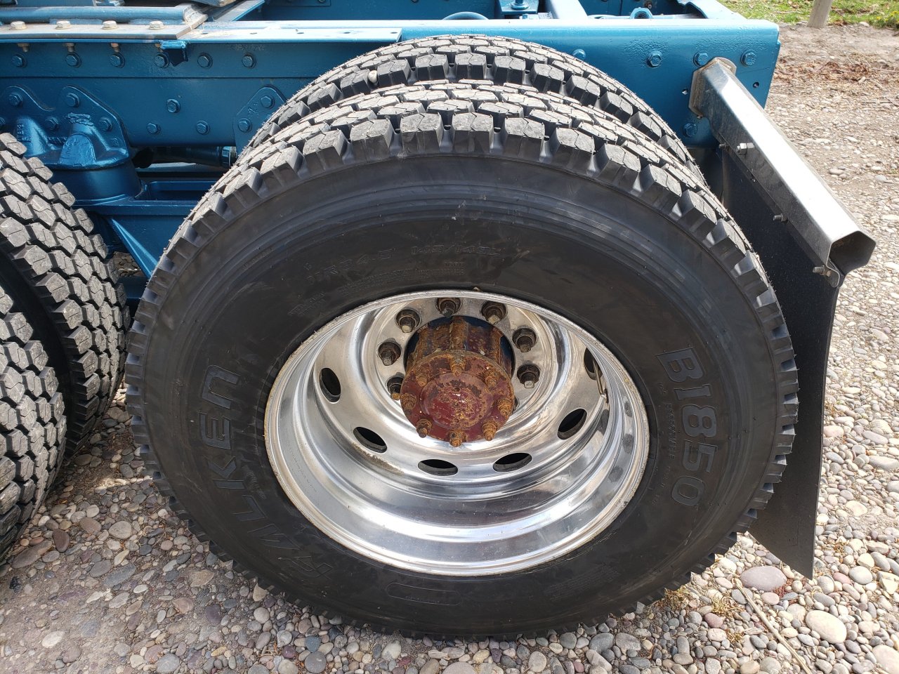

    96000 on them now, had them siped last fall. They are wearing flat, and probably have 40% left, which is pretty good in our application. We get up around 55000 lbs. on the drives with our big excavator, 65000 witth the tag,, so getting 100,000 miles is pretty good for us. The only thing bad that I have to say is that a couple of them took around 15 Oz. to balance. They were all I could find in tall 16 plys without ordering something in at the time. I don't have experience with 830s, but I do feel that Falken is a good brand.

    Looks like the difference between the BI 830 & BI850 is the 850 are open shoulder
    Thanks for the info ..
    I've always run either Continentals or Yokohamas... can't seem to hardly find tall 24:5 's from either of those 2 anymore
