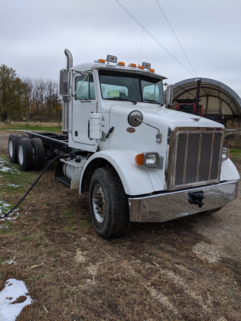

    Well, just an update, I bought a Pete 357 cab chassis with a Allison 4560, Cummins ISM, double framed, 46k rears and 20k front. Waiting on getting the rest of my body bids, but should be into this truck for around $48-55,000 total. I'll try to give a update when I get the body bought.
