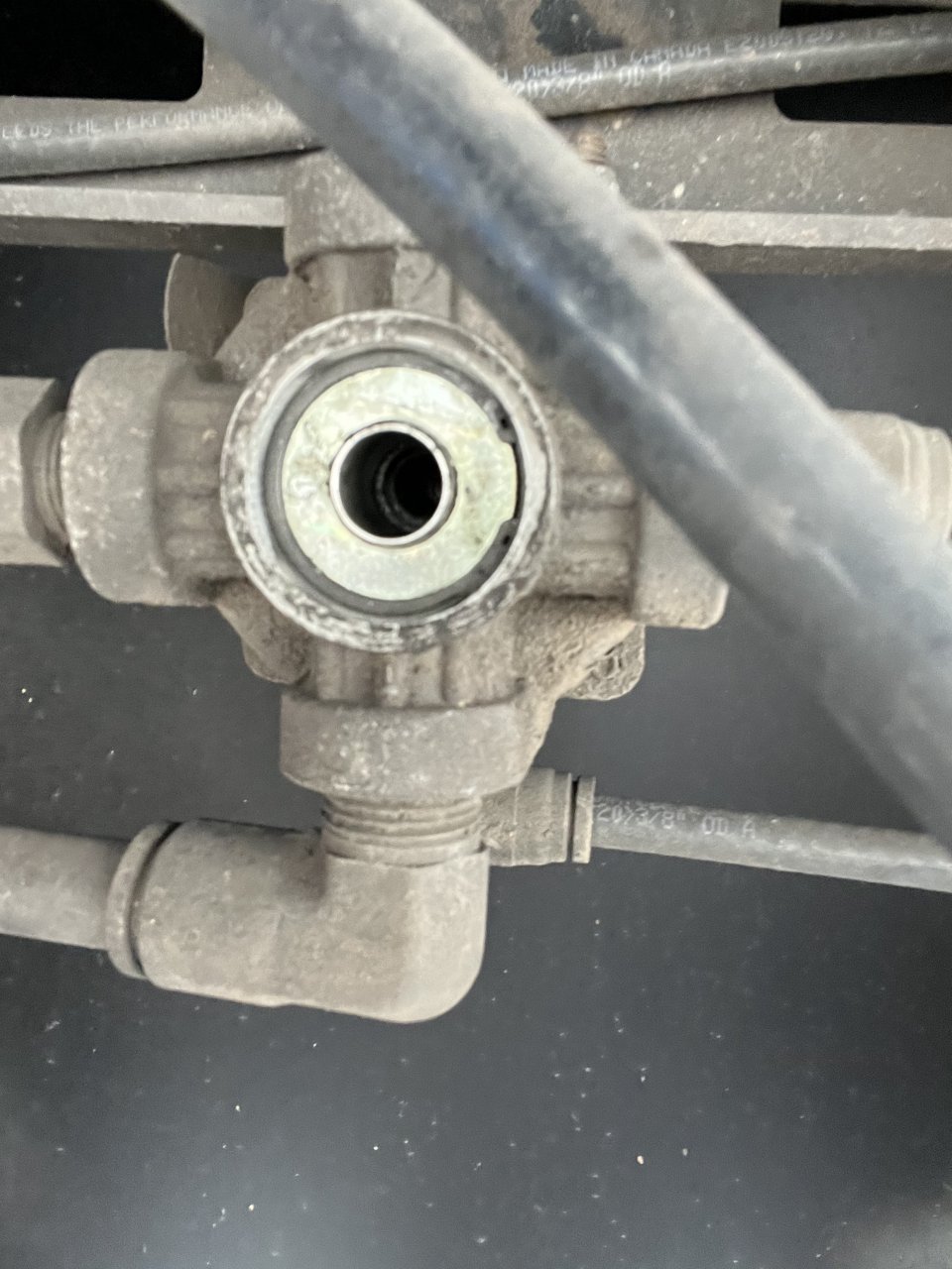

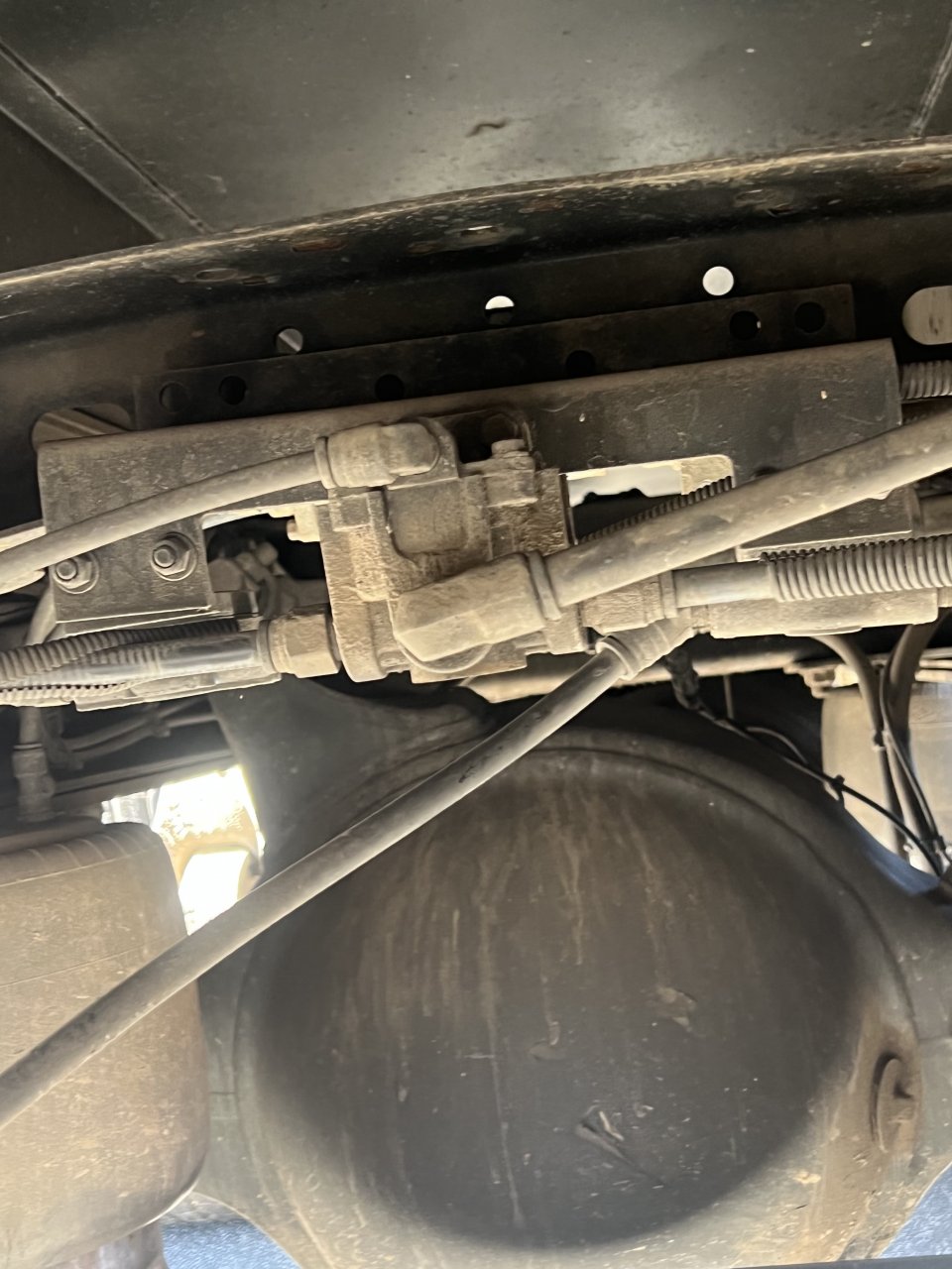

    This part here is leaking a lot of air is it supposed to? My air tanks aren’t even filling up. What is this part called ?

    If I remember correctly on my Peterbilt it is called an R-12 relay valve, don't know if it is known by other designations on other trucks. And no, it should not be leaking air.

    What model/year/truck?

    It's froze, and THAT'S a hassle. If it's any consolation, with temps in the teens in Shreveport, you aren't the only one.
