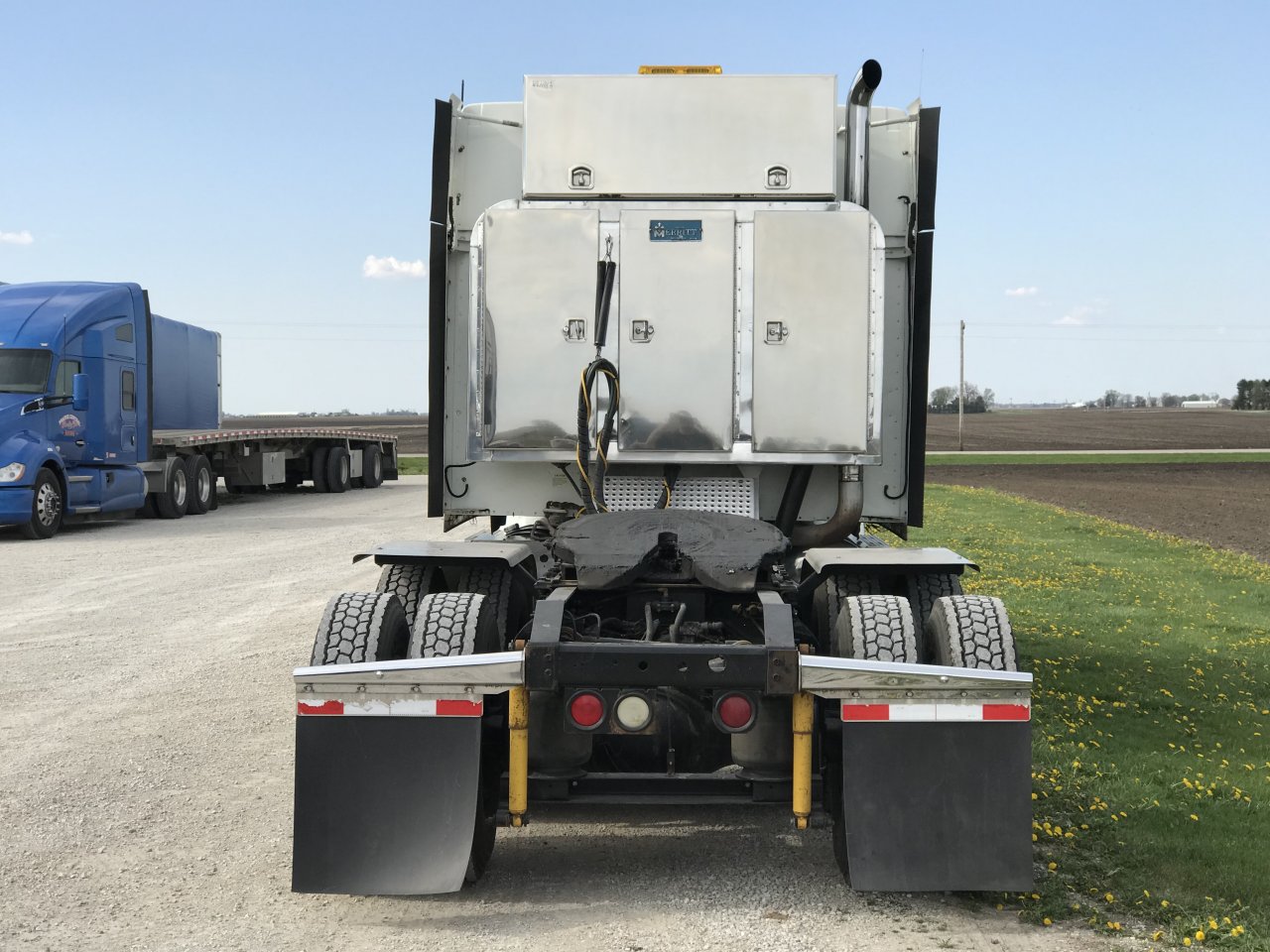

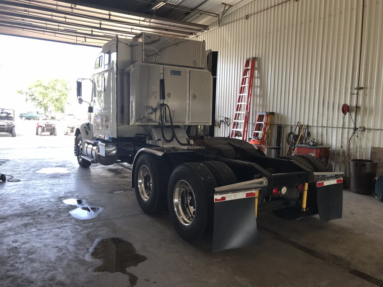

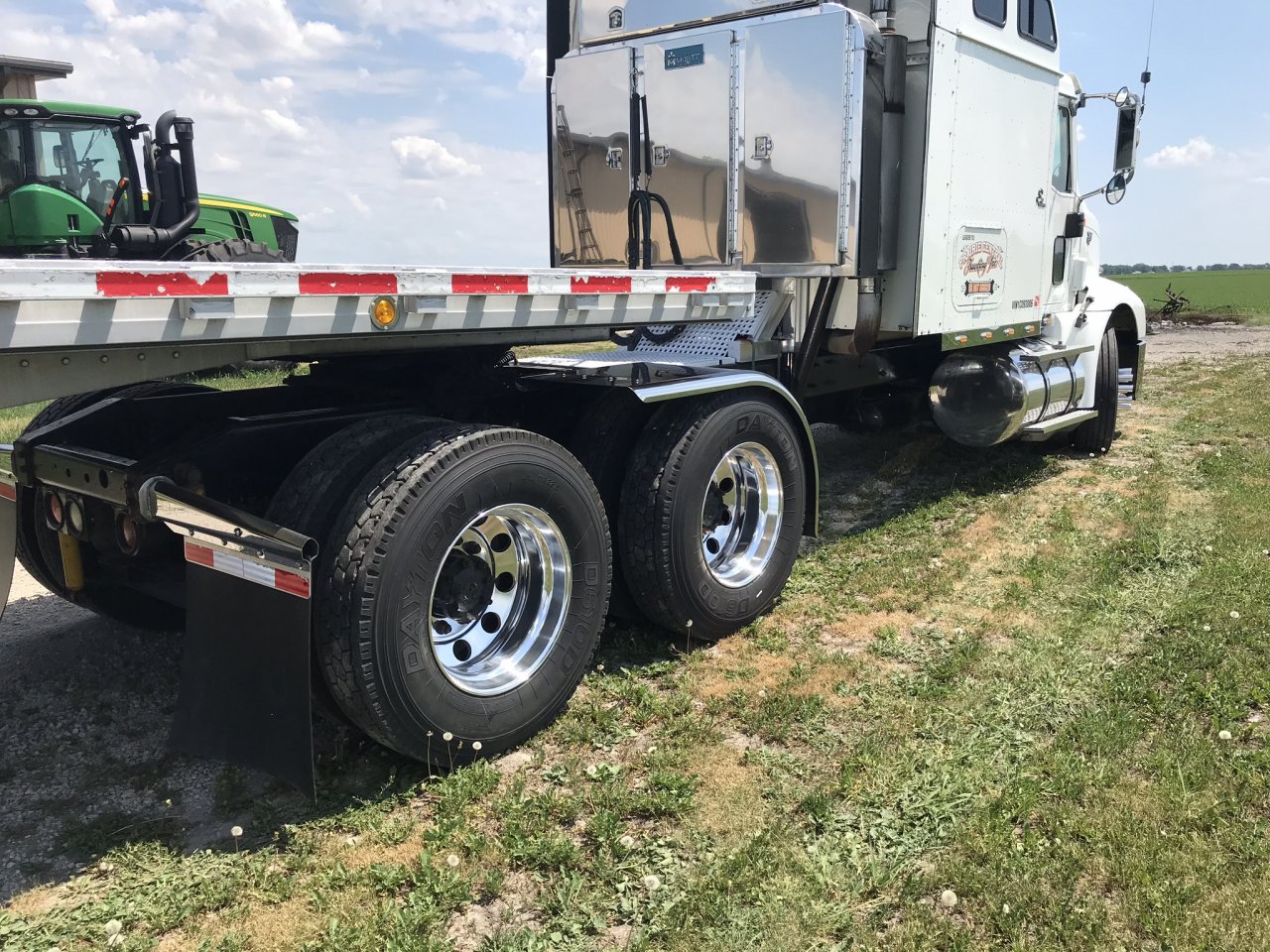

    Yup... nice! Is it attached up to with a spring so it can stretch? Or does it not need to?

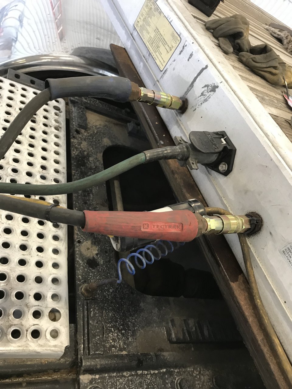

    I have had much fewer problems with the quick connects than any gladhands I’ve used since 1992.
    I will never go back to gladhands on my own equipment!!!!
    3519DC63-41AF-472D-B96F-F5576A7567B5.jpeg FF5AC540-D539-47FE-AC19-C24A0B4CB1D7.jpeg DEE15008-C638-47F6-A518-8654F772B1C0.jpeg
