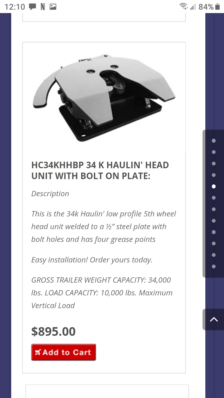

    So yeah, that's definitely the Binkley/Holland FW0001 on a nice hitchcrafters bolt on C&C mounting plate. Used to be the best light duty 5th you could get. From my understanding there really is no adjustability on them. I see 3 good options, but the 3rd might require a new mounting plate..
    1-- Get a fw0001 rebuild kit for it, & have it rebuilt.
    2-- I can't seem to find the actual part # on this, but it looks like a slightly upgraded model of what you have now. Also the least amount of down time as 4 bolts out, 4 bolts on & your ready to ride again. Just call hitchcrafters & verify that the bolt holes will line up with new vs old.. This is from Hitchcrafters site.. Screenshot_20200703-121032_Samsung Internet.jpg
    3-- The Holland fw6000. Much larger top plate with higher pin load rating. Might be even more stable if that's what your after.? 22" top plate I think I read.?
    Cost looks about twice as much as the new 34k lb deal from hitchcrafters, & it may or may not line up with the holes on your current mounting plate. May be as simple as just drilling new holes..
    You are probably right about you kingpin being fine, but never hurts to double check it's tight. If your current 5th is a little sloppy, it could be beating up on the kingpin welds..

    I like not having down time but I wish they'd say what brand it is. Wonder if this would also give me problems after 70k.
    Holland FW6000 looks nice, not sure it's $1900 nice though... I am looking for a wider plate for it to be a bit more stable.
    I'll keep looking at options, I might just end up ordering again from hitchcrafters.
    Wonder what my used one is worth?
