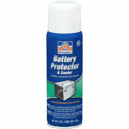

    I've had good luck with this, and it is red.
    Rideandrepair Thanks this.

    Freightliner dealer here uses the permatex stuff whenever they work on electrical or setup a new chassis with a body. They sell it in the parts department. 3M stuff costs almost twice the Permatex depending on where and if you can find it.

    When We bought our new ‘99 and ‘03’s the batteries were painted with that stuff from factory. So sloppy you Couldn't read the labels. Lol. White colored trucks and the firewalls next to the cab junction plugs were over sprayed with with that stuff looked like crap all over everything.
