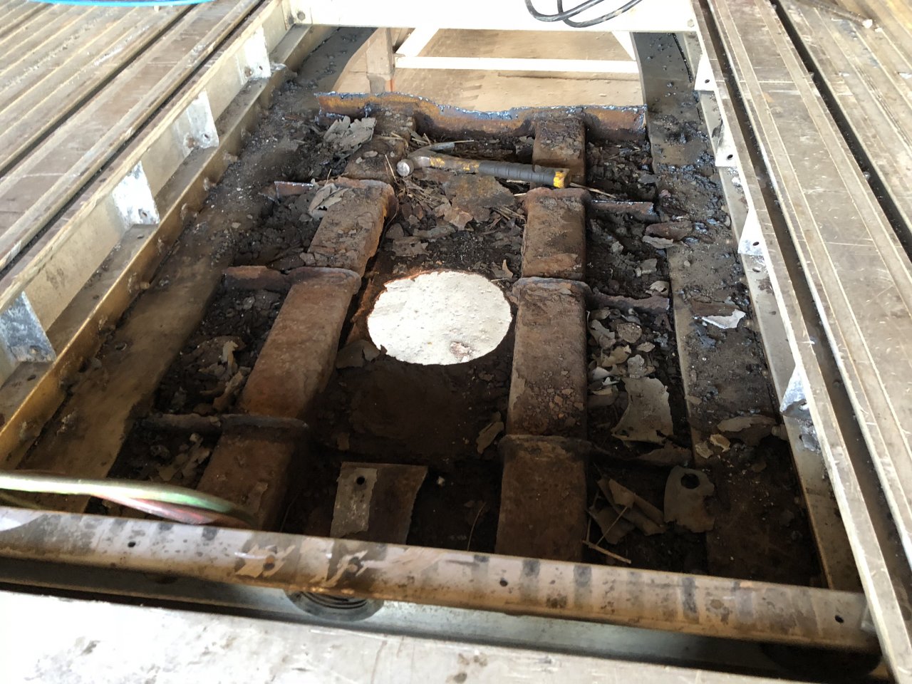

    This is inside the kingpin plate on a 2007. It’s hard to get in there though clean but look in there the best you can from the back. The kingpin rusted out and broke off on mine earlier this year. After we cut the deck off I was shocked to find this mess. 0D5F37BE-E7E3-4209-BED4-EAC183D6031A.jpeg
    We have both the newer and older style suspension attachments on ours. I the le the aluminum l bracket much better.
    Mine is the steel bracket and dose ok if you keep it clean in there.

    Ok thanks for all the advice guys!
    Wow that 5th wheel plate is bad man

    That is bad. On any trailer I'm looking at buying, new or used, I'll crawl up under and look for places that don't drain well and catch debris. You can guarantee that underneath debris and moisture traps are going to cause problems.
