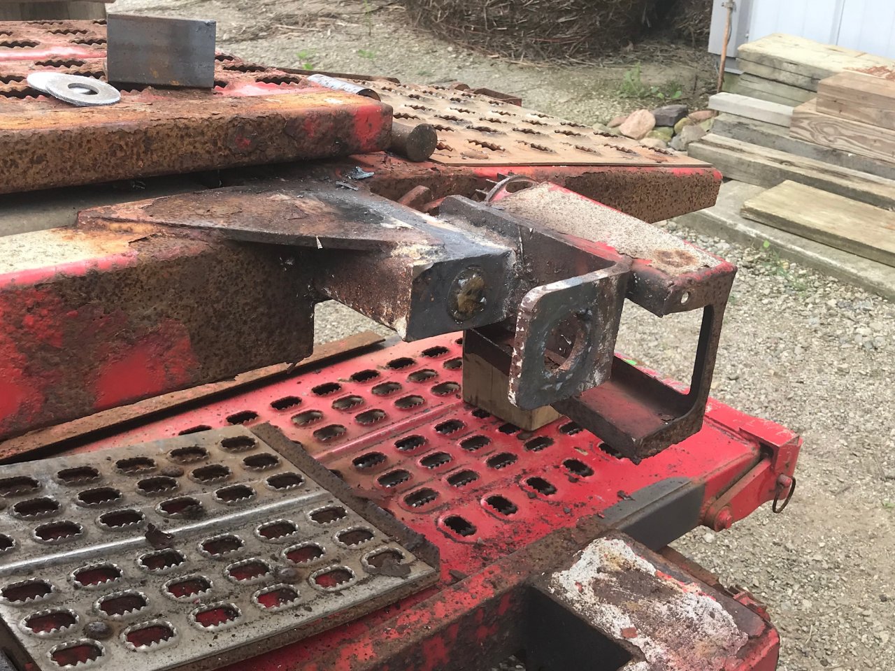

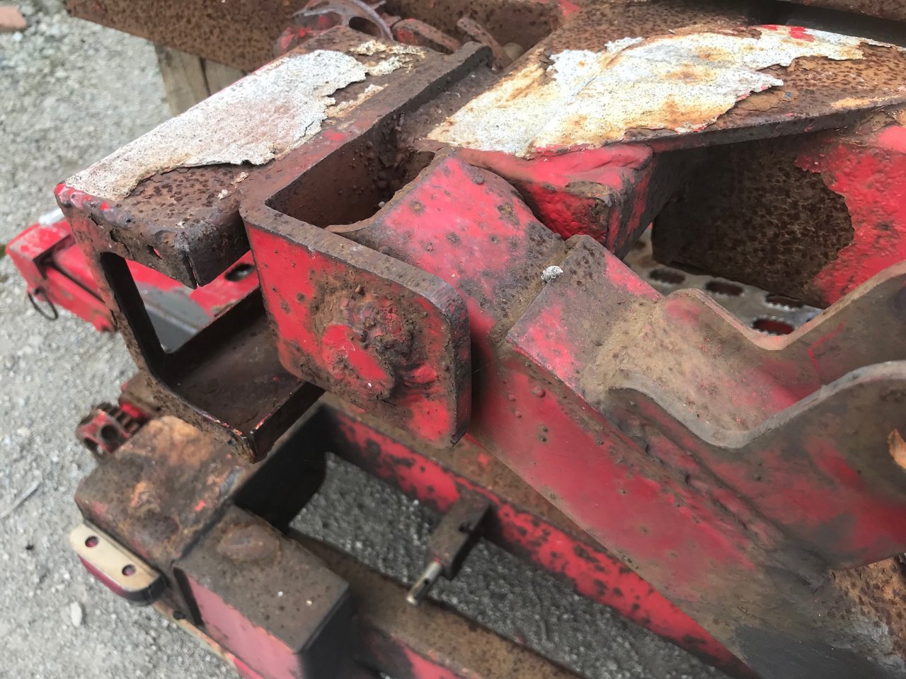

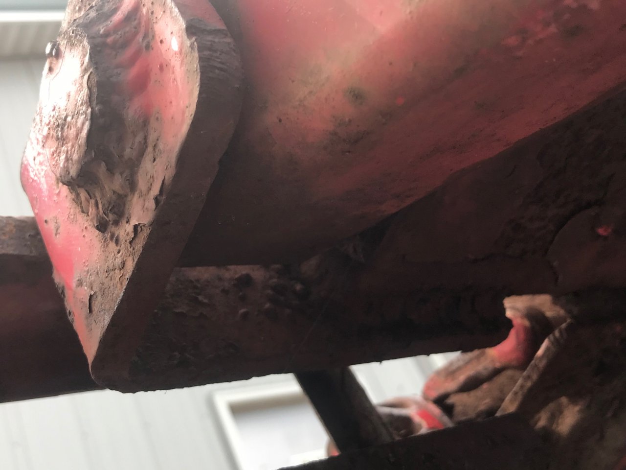

  5. blholtx
    blholtx Bobtail Member
    6
    4
    Aug 19, 2018
    This is what it looks like on one side of trailer. There is no way to get to the back side of these pins to drive them out.
  6. Blackshack46
    Blackshack46 Road Train Member
    Looks like a cutting wheel is in order. That pin isnt going anywhere while its still welded in place.
    magoo68 and AModelCat Thank this.

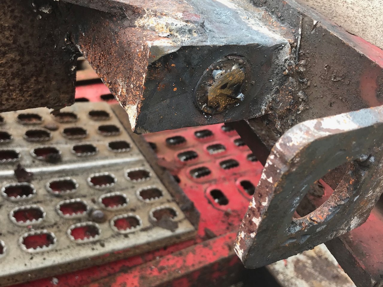

  7. blholtx
    6
    4
    Aug 19, 2018
    This is the side I’ve been working on. Had to use a cut off wheel to get the slide tube out of the way, unfortunately it doesn’t give me anything to work with. I welded a bolt to the pin and used washers and a nut to put pulling pressure on the pin while heating the tubing that the pin sets in with a torch. The threads of the bolt pulled inside the nut.
    I’m thinking of trying to either drill and tap pin for a 5/8 inch or larger bolt and use a grade 8 bolt to put pulling pressure on the pin and use that along with heat.
    These pins are original in the trailer.
    Klleetrucking Thanks this.
  8. Cattleman84
    Cattleman84 Road Train Member
    9,602
    67,009
    Nov 1, 2017
    The Sticks, Idaho
    A man that is good with A cutting torch can blow that weld out and free the pin... But they need to be GOOD with that oxy-aceyline torch... You don't want to cut the plate that that pin is welded into... Only the weld... If you are go in to replace the entire pin then you can cut the weld and the entire top of the pin, but this may make it difficult to remove the pin once it is free. I have had to do exactly what I have explained here many times working as a welder/fabricator/repair guy.
  9. Cattleman84
    9,602
    67,009
    Nov 1, 2017
    The Sticks, Idaho
    For the side that you have already cut... Heat what is left of the pin just as cherry hot as you can get it... Drench it with penetrating oil, let sit an hour and repeat process... Do this 3 or 4 times, the last time after you heat it don't put oil on it but just let it sit over night... Then weld a large nut to the end of the pin and put a 1/2 in impact gun on the nut and give it a rattle... The nut may need to be rewelded on a couple of times but this will eventually work it free.
  10. Cattleman84
    9,602
    67,009
    Nov 1, 2017
    The Sticks, Idaho
    Another thing... Those pins might actually be threaded in... Not sure as I'm not sure of the application,
  11. blholtx
    6
    4
    Aug 19, 2018
    Lol I know that much. Look at pics
    thanks, pins are actually smooth. I’ve got replacement pins for both side. Those pins are inches long. Only about 31/2 inches go thru the vertical tube and the outer bracket. The rest is inside the horizontal deck tubing
