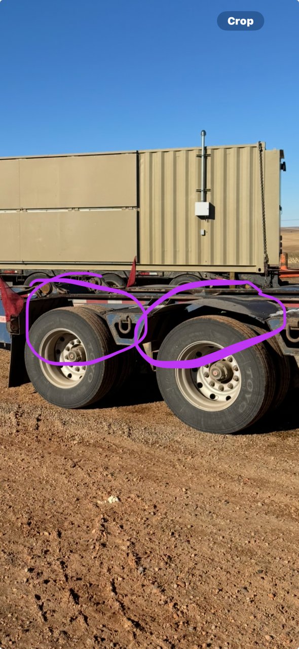

    Looking to see what are guys using for the back trailer fenders.
    I need something hard that will keep its shape but also allow me to drive equipment on it so it will pop back out.
    You can see on picture below where 1 is missing.

    Mine are open. I think @ElmerFudpucker built some for one axle on his old trailer. He might have made them detachable on one end - I can't remember. He should be along at some point.

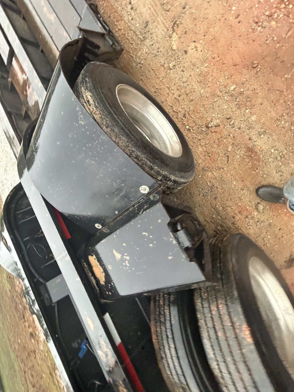

    I built them for the new trailer too. I can completely remove them if I want. 1/4” pvc sheet cut in half. Then ripped down the middle.
    Feedman, W923, cke and 2 others Thank this.

    I used 3” channel as a riser / spacer then covered it with 3/8” plate. Needed the ability to haul a mini excavator with no issues of it contacting the tires. But has since been very helpful in hauling other equipment….

  6. ElmerFudpucker
    4,037
    42,815
    May 17, 2024
    IMG_3146.jpeg IMG_3145.jpeg IMG_3144.jpeg I ran out of fender washers

    Middle picture looks a little wonky but it’s just the angle

    One thing about the pvc is that it will crack if you don’t pull the pin out of one side and let it lay on the tire. Especially in cold weather

    And it’s ABS plastic not pvc. Sorry

    THATS what I'm looking for!

    It’s like 100 bucks for a 4x8 sheet. That will give you 4 fenders. I found my at a local plastics dealer in town.
