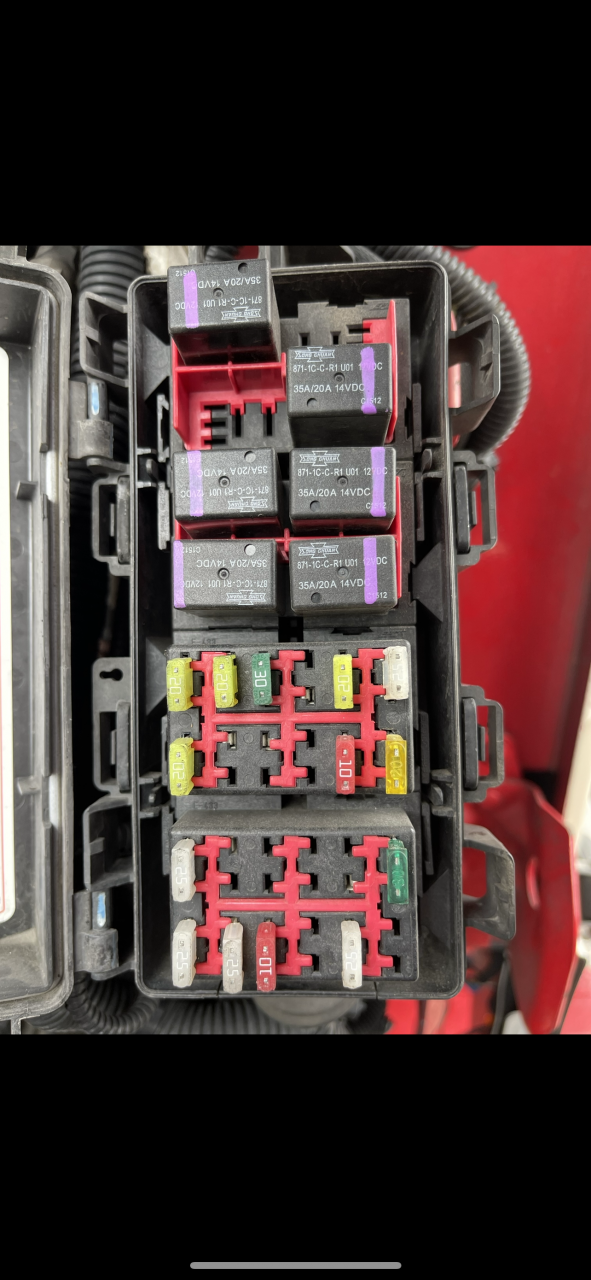

    2015 389 PeteGlider My left turn signal on the front, hood and mirror went out recently. My rear left turn signals and left side of trailer worked fine. I found out that there was a separate fuse for the front left signals and the rear of tractor and left trailer signals.

    I can't see anything in the fusebox that says LH/RH on my KW. I haven't checked the power distribution box under the hood yet. I know it has a bunch of chassis node fuses in there...so I'll check when it gets back to the shop.

    5A54C295-288D-4301-9C27-82F982DEA7C7.png 38303598-FCAC-45E4-88B8-03AC9F3D1F1D.png Mine is in the box under the hood. I think it was the power g3 for the left front turn. I assume the rear will be in the same box.
