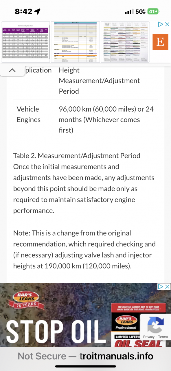

  6. Rideandrepair
    15,688
    51,597
    Aug 8, 2015
  7. MRMTRANS
    MRMTRANS Light Load Member
    169
    210
    Apr 28, 2015
    I am approaching 60k. I planned on doing it then. But I'm not getting home so I'm going a little beyond that. I am guessing it's not critical at all to do 1rst adjustments by 60k. Maybe I'll post how far out of adjustment after it's done.
