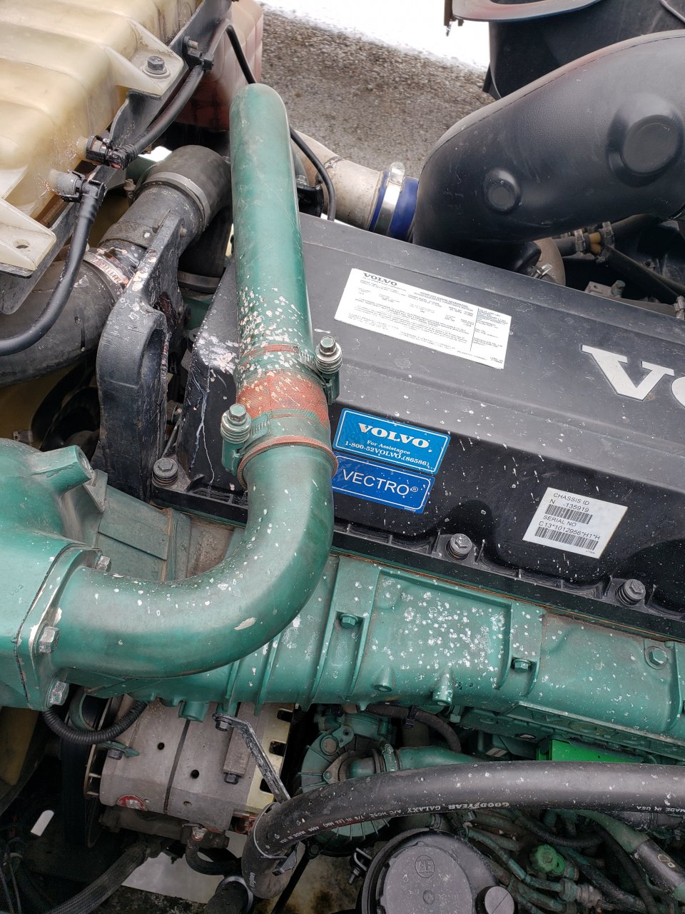

    Seems like my engine is pushing coolant through those little hoses at the middle of the coolant reservior now.

    Not normal if the coolant is pushing past the tubes and blowing all over the valve cover. They are thinking my air compressor is going tits-up. The air compressor has been rumbling more and making alot of noise lately. A failed heaf gasket on a compressor can pressurize the coolant system.

    If the compression test is accurate , shows a drop in compression capabilities from cilinder 4 to 5 and worst 6, could be head gasket if cilinder close to each other are affected.

    I was thinking that too. Volvo wants to do a coolant pressure test now. I guess that will tell me if my head gasket is toast.

    Starting to wish I had a big red motor more and more every day. :( 20190215_115247.jpg 20190215_115255.jpg 20190215_115250.jpg
