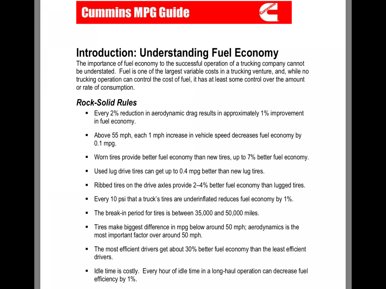

    Aug 19, 2012
    35DD57D8-A39A-4902-910A-9069F92A0574.png 5576E1CA-4E15-44DC-8313-335E36A188AF.png
    Here are a couple manufacturers opinions about the topic. Remember that the way your truck is spec’d including things such as tires, aerodynamics, rear end ratio, freight and numerous other factors can effect your actual results. Dig around on their sites and you might learn some interesting facts.
