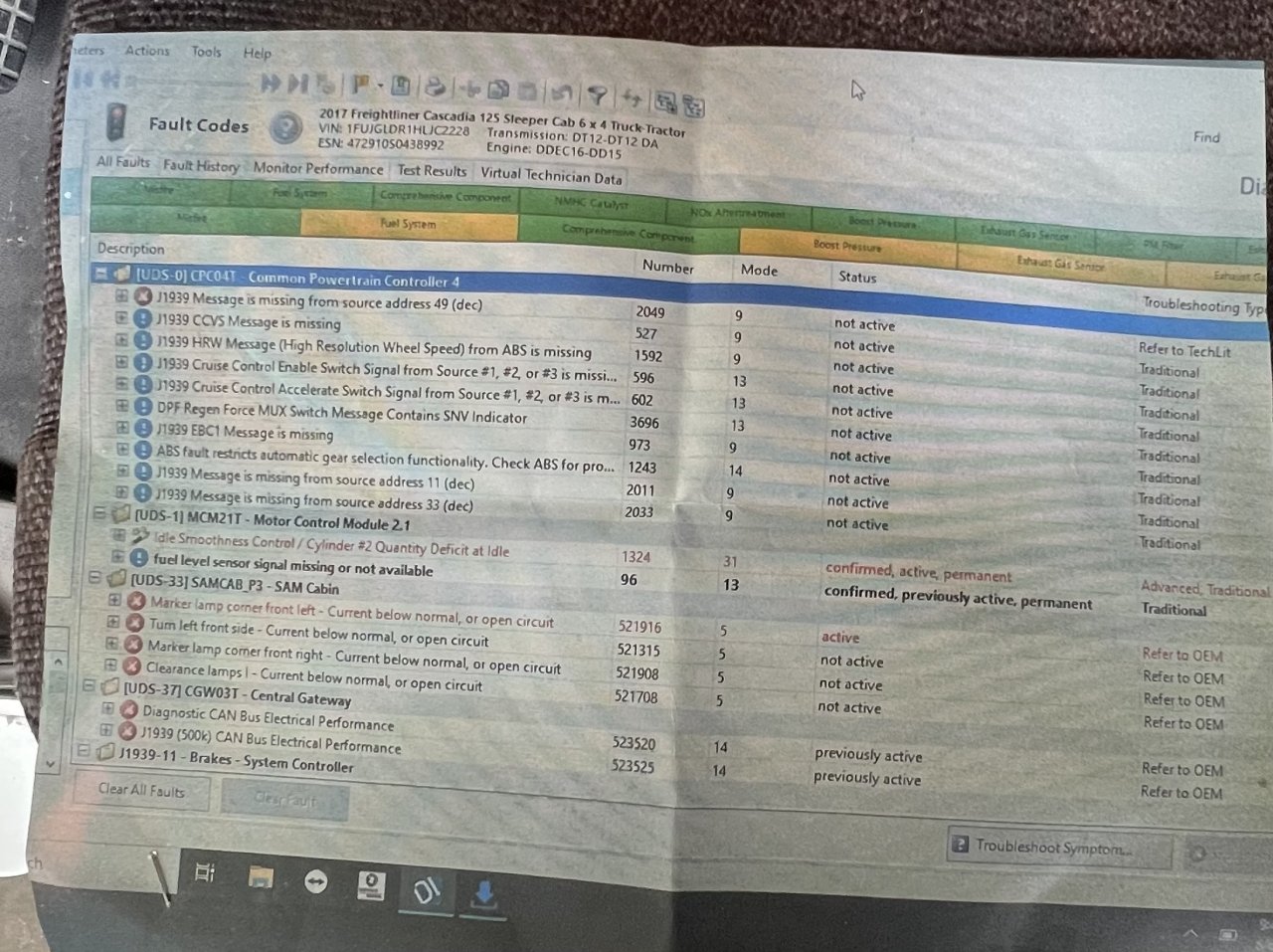

    Hello, I need help. I have a DD15 that gave me an SPN code of 1324 FMI 31, cylinder 2. I changed the harness, QCV, rail pressure sensor, and calibrated the valves. Now I'm changing to cylinder 3. The rail pressure is good, and the cutout is failing. Cylinder 3 has no smoke or fluid loss. Thank you.

    Section 86.1 SPN 1324/FMI 31 - DETROIT MBE-900 DDEC VI Troubleshooting Manual
    Miles? Need to run a relative compression test. Look at the cam lobes, adjust the valves. If that test fails then you found the problem. If it passes then only the injector is left as you don't have any leaks.

    When you have a new problem after a repair go back and check your previous work.
    Start just like you have never seen the truck before.
