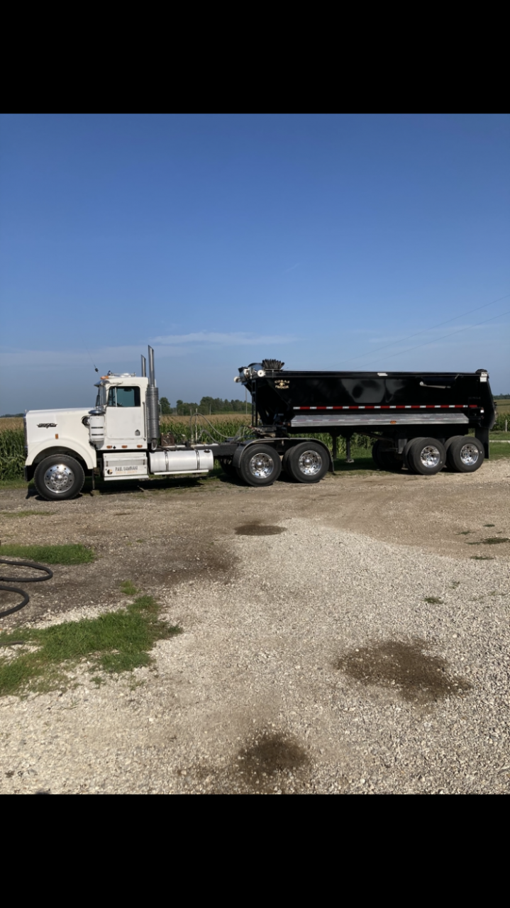

    I know the op has a dump truck with Hendrickson and an AG100 is usually not liked for a dump truck.
    My daycab semi tractor w9 with Hendrickson RTE has, what looks to me anyways, the same torque rod setup as an ag100. I look at ag100 cutoffs online and the center crossmember that the front and rear torque rods bolt to is the same as mine. I feel like I could get the ag100 cutoff and be about half ahead of the game by drilling new holes in my current frame and bolting up the ag axles/torque rods/center suspension brackets etc
    Nobody messes with ag100 anymore so they’re somewhat cheap and plentiful and good lord it’s gotta be more forgiving than a Rte
  7. Gambino1994
    Gambino1994 Light Load Member
    187
    103
    Jan 22, 2009
    causing a situation
    I’ll betcha other than the double frame I got the same suspension you got. I have a 3/8 single frame
