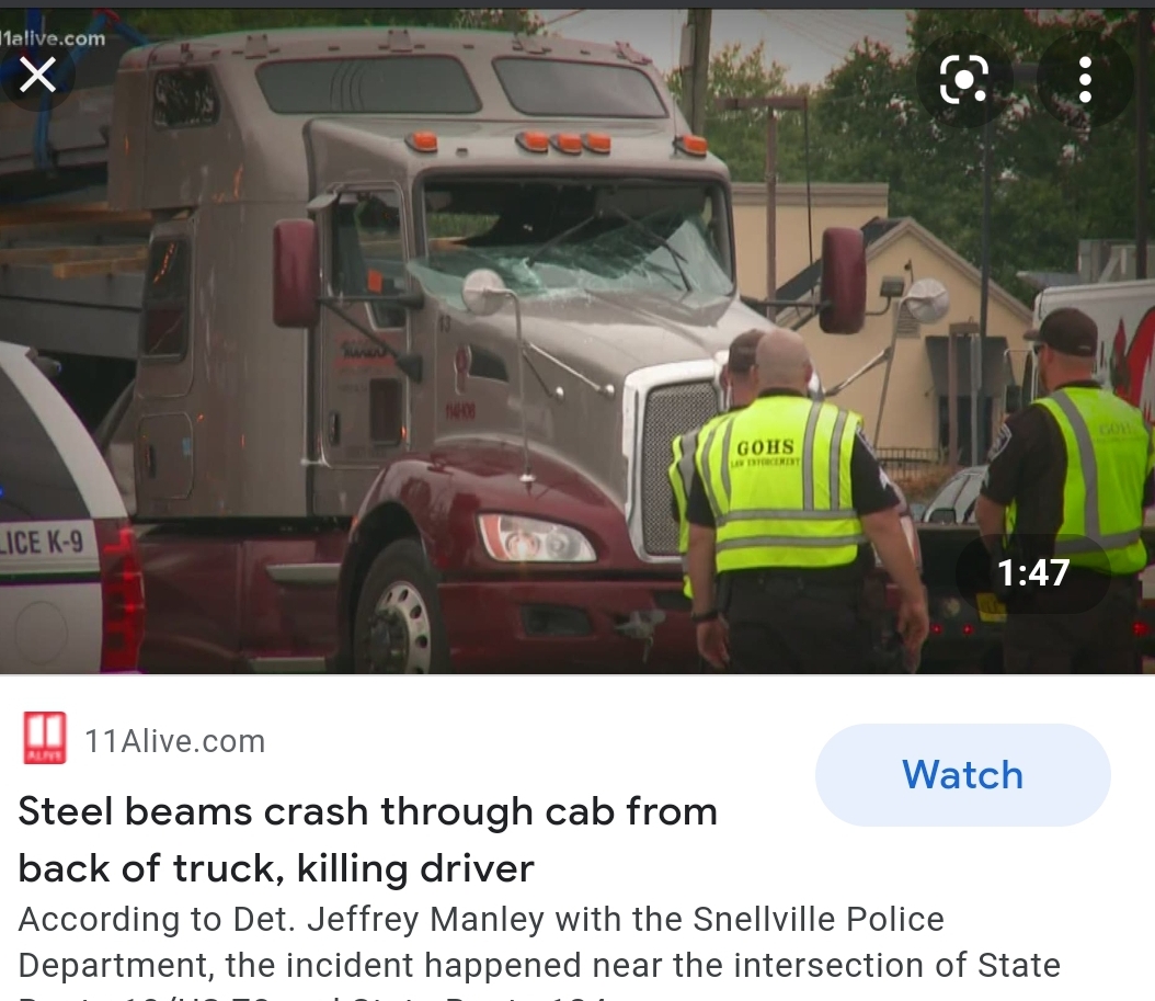

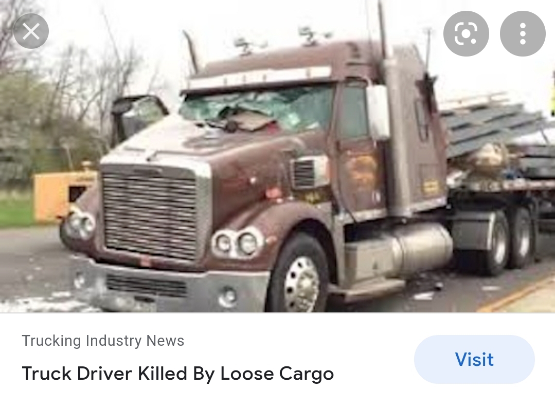

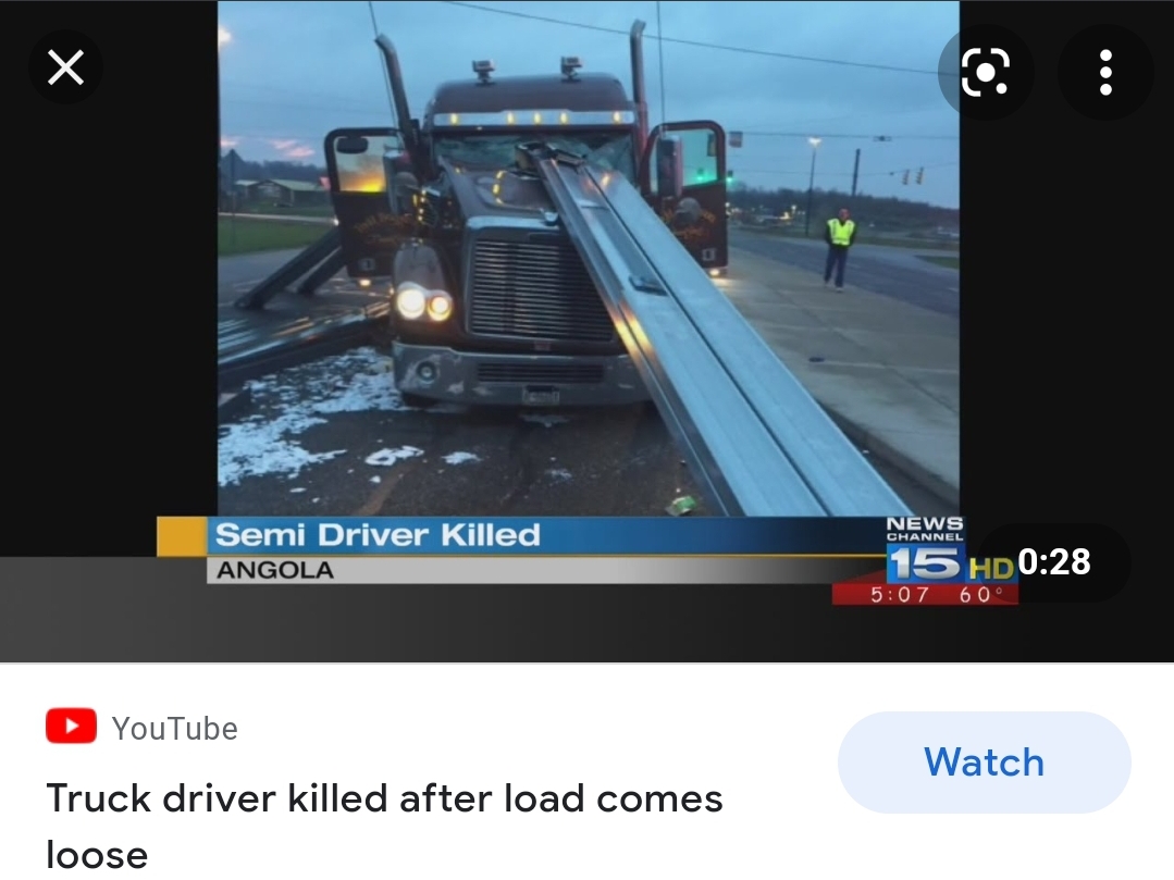

Steel beam loads killing lots of drivers, any advice?

    It starts with the loading. Just like lumber can walk out the center, sometimes beams will also.
