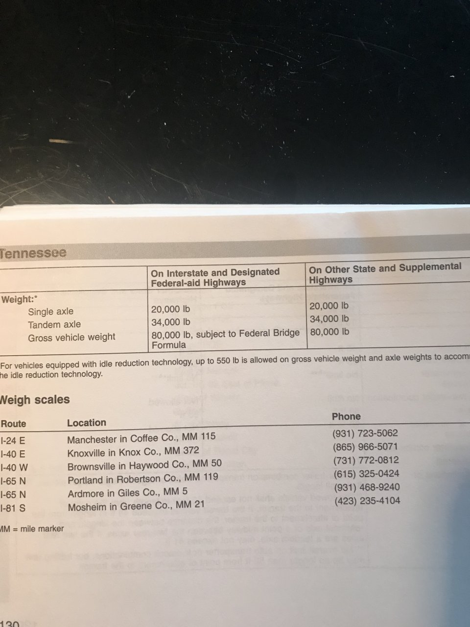

    Do you guys know steer axle weight limit for AR, TN, NC? I tried looking in my atlas but for some reason my atlas doesn't have it

    Per the 2017 book, the AR and TN limits are 20,000. NC is not specified, but any single axle in NC is also 20,000, which should cover your steers. Someone correct me if I'm wrong please, don't want to give out bad info.
    If you have a motor carriers atlas the info you are looking for is on the State and Provincial page, not on the National Weight and Size Provisions page.

    Brotha D... that is correct on NC. 20K

  9. truckdriver31
    6,988
    8,343
    Sep 18, 2013
    0632F0FD-32D5-4945-B730-C4CE528E5DFD.jpeg DBA8546D-2C2C-4EC3-9FF6-303F8159E821.jpeg 07A9D579-CCE9-445F-88FA-F8B8437F28A2.jpeg 07A9D579-CCE9-445F-88FA-F8B8437F28A2.jpeg
    Jdm5jdm5 Thanks this.

    but also cant be over gross
