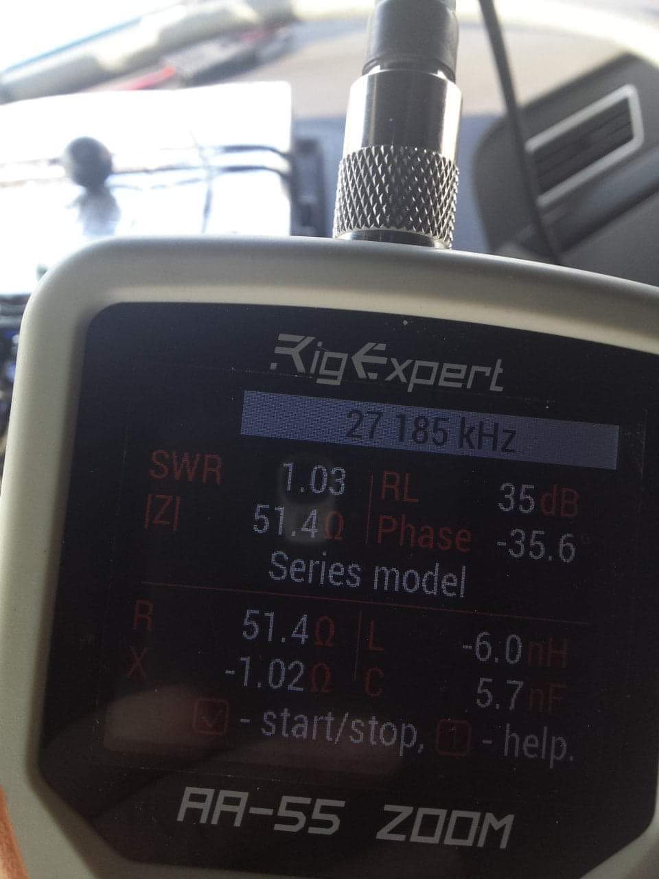

Start with a pair of skipshooter. 2nd find a cb shop that has an antenna analyzer ..Or if you wanna learn,buy your own..either way you want #'s close to these except in 75 ohm vs 50
