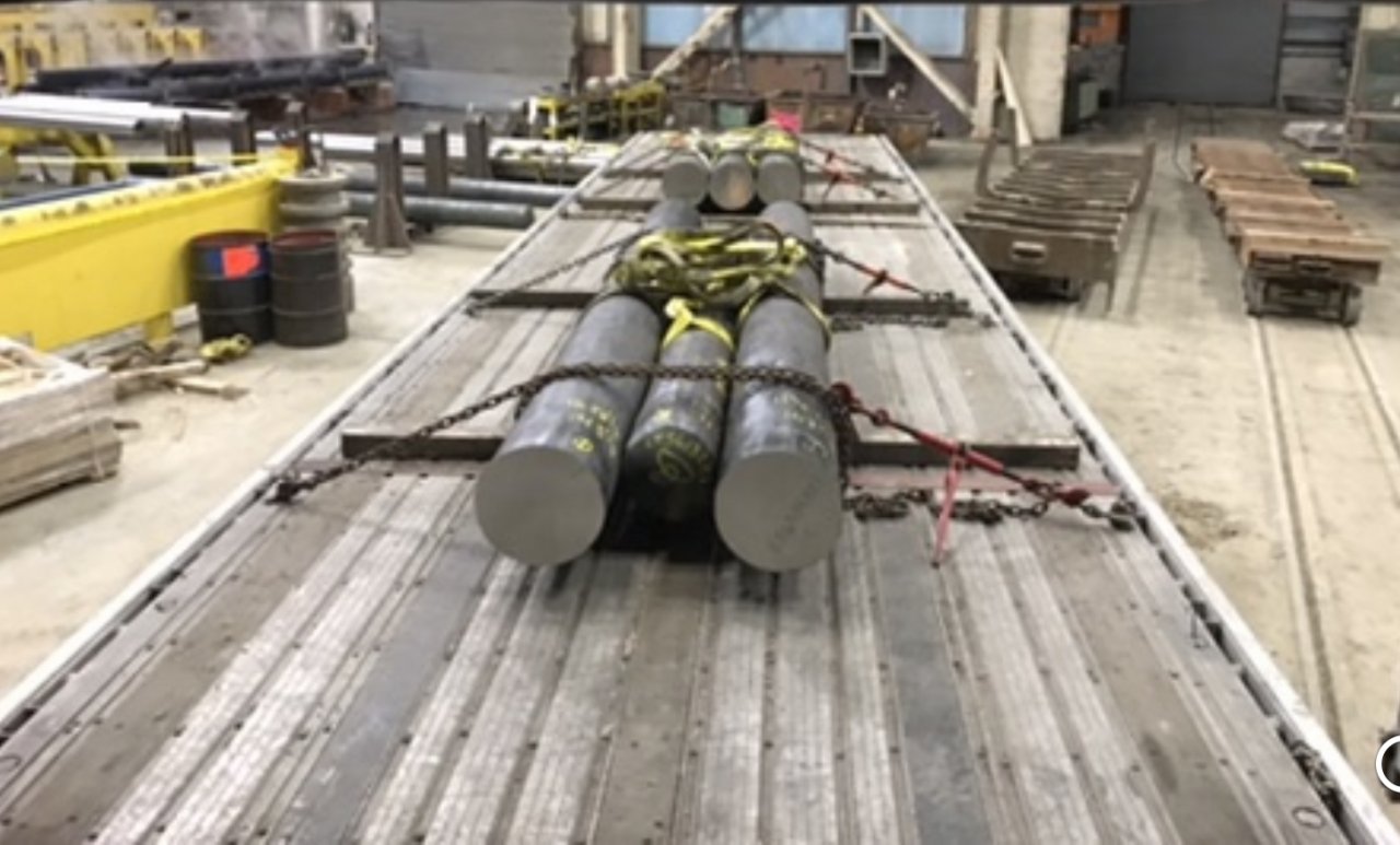

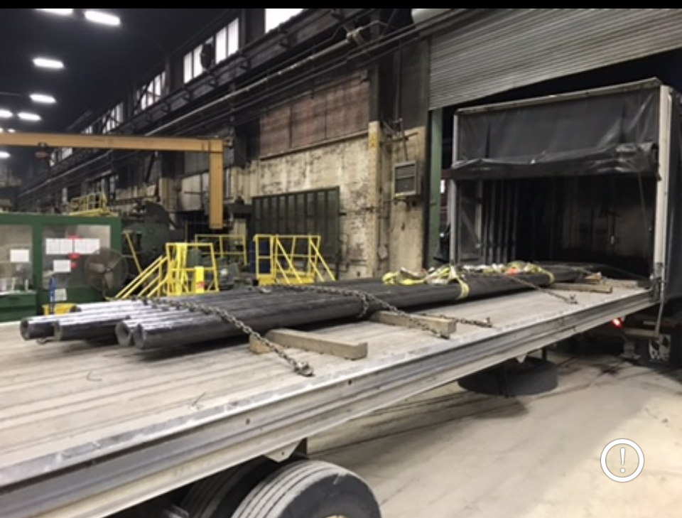

    I’ve hauled a lot of round stock over the years as well as steel pipe. I always “belly wrap” in at least 2 places along with the other over the top chains. When you belly wrap it pulls the stock / pipe together and makes it more difficult for any or all pieces to move forward in a hard braking situation. The round stock in the bottom pic averages around 2800 to 3200 pounds each, no aluminum head board is going to stop it, may slow it down when it comes forward like a ram, but stopping it is very slim. As mentioned earlier driving like you have some sense helps too…
