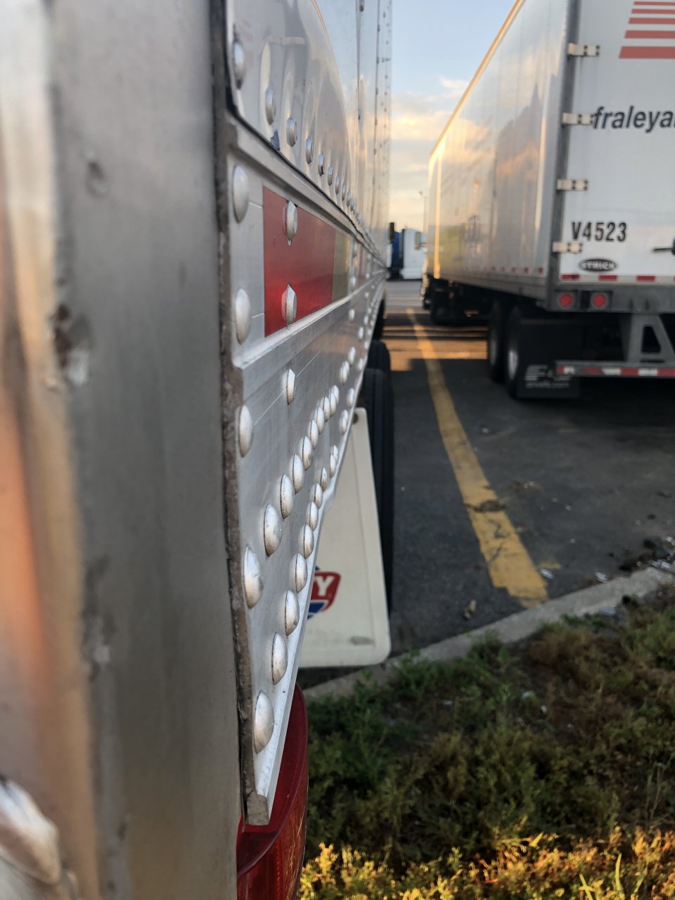

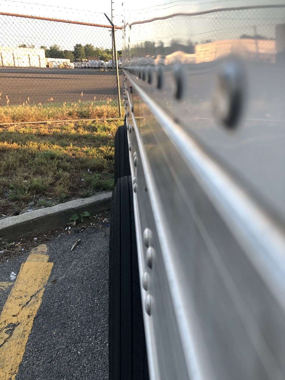

    So I changed my super single tires on my trailer to doubles & they are a couple of inches sticking out from trailer. Anyone know what I have to do in order to fix this ? ‍♂️

    I'm no trailer expert but I would say your hubs are offset specifically for singles. Most likely changing hubs would be needed. I would contact the trailer manufacturer. Might cost more than its worth, if its even possible.
    Looks cool........but not legal.

    You need narrower trailer axles, axles were designed for wide base wheels. Bummer.

    If its a 102in. wide trailer you may have to put the super singles back on till you can buy a set of the narrow axles from truck used parts yard?

    Cant put duels on some of the newer trailers the whole sider is wider

    Put some rubber extensions around the top lip of trailer first , instead of changing everything out.
