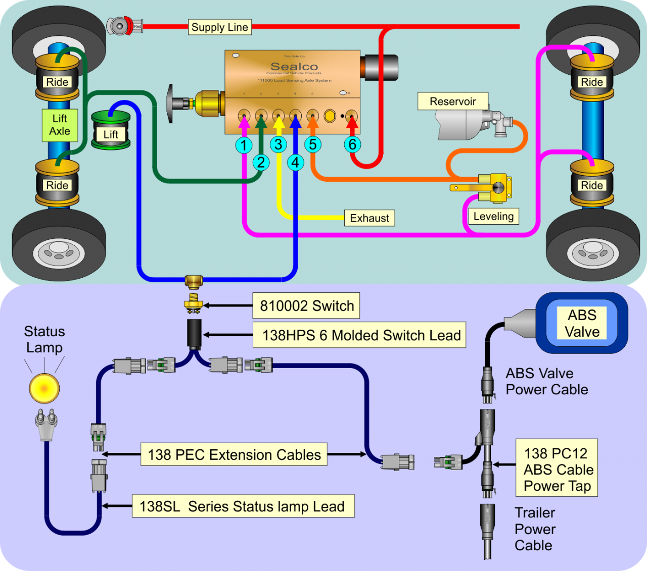

    My bet is your blue wire/center pin on your pigtail is not getting power. That should be a keyed Constant power source to run your trailer abs system and bother 12 volt accessory’s like your lift axle valving.
    When you turn the key on the trailer and light should light for a second, then go out. That’s the system self test. I bet yours doesn’t. If the light stays lit you have an abs fault.
    The trailer abs system can also pull power from the brake light wire when the brakes are applied. This is a back up Incase the center pin is not working or you have an older truck that’s not wired this way. When you step on the brakes it’s back feeding to your lift axle system and everything works right until you let off the brakes, the valve loses power, and defaults to all axles down.
    Notice in this diagram from Sealco that the pressure switch pulls power from the “ABS power tap” in the lower right hand corner.
    TL:DR your ABS fuse on the tractor is probably blown.
    EDIT: when I was proof reading I noticed that the Sealco valve only uses power to light an optional indicator light. It’s a “dumb” valve that can’t be integrated into other systems, such as stability control.
    The Haldex ILAS-E valve is probably similar to what you have on those trailers.
    ILAS®-E Valve
    The Haldex ILAS®-E Air Suspension System Valve can control the position of the lift axles through an electrical connection. A 12V power supply is needed to keep the lift axles in the raised position. When power is removed, the lift axles will automatically be lowered. This can be simply controlled via an electrical switch.
    When coupled with the Haldex TRS System, the lift axles can be controlled to raise and lower automatically as the air suspension reacts to changing loads in the trailer. The ILAS® E / TRS System can be adjusted to react at various pressure conditions making the system versatile for single or multiple lift axle trailers.
    Reason for edit: Correction.
    RockinChair, LoboSolo and Dave1837 Thank this.

    I wish there was a super thank option available on here. This helps me greatly. I have my truck home for the weekend so I'll start digging into it to see if I can trace all the possible issues. Thank you very much
