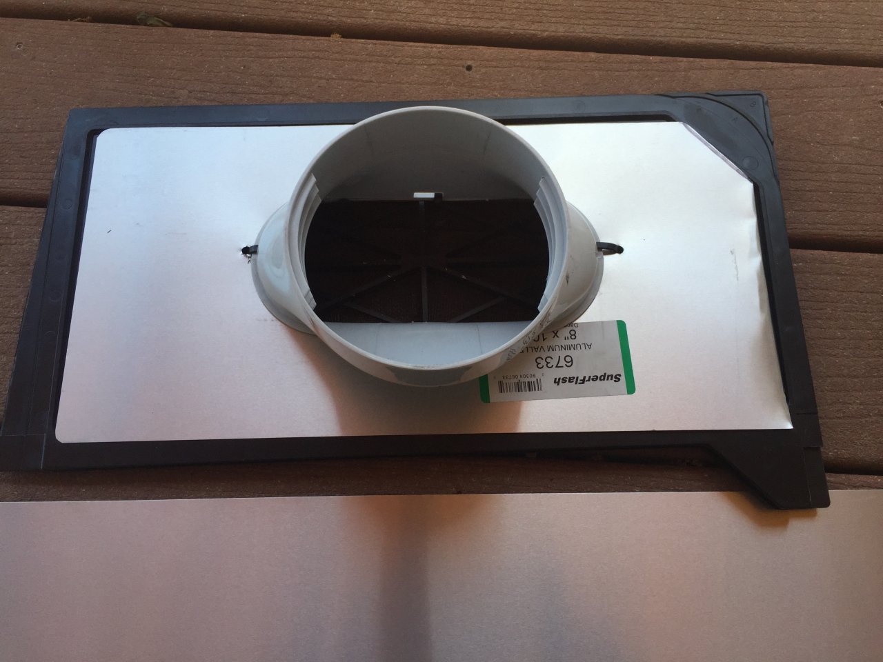

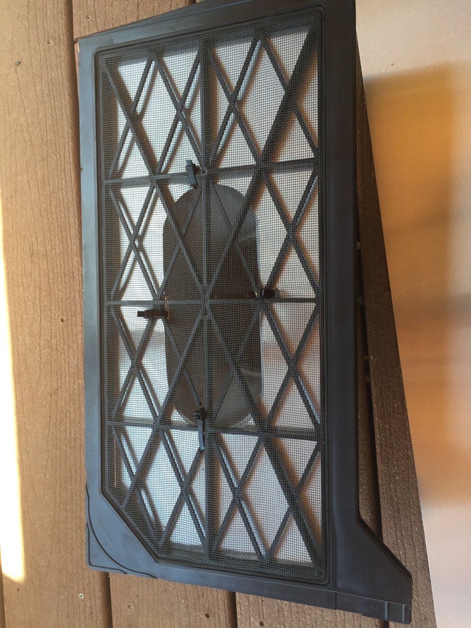

    Breezeway screen, with some aluminum flashing cut to shape.
    Good old cable ties.
    Whammo Blammo - exhausted AC.
    Went down and ran the new set up for a while. All good. Have to drop in to Lowes and grab a roll of "sun visor " aluminum foil insulation stuff to fend off the windshield greenhouse effect.

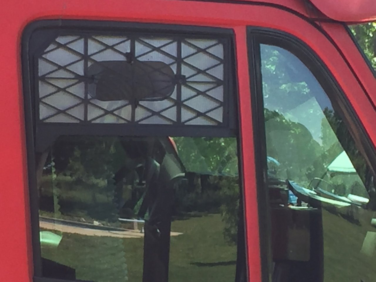

    Make sure you do the side windows as well. Makes a huge difference. The one I use for the windshield, I made double thick to give rigidity. The side windows I made just a little tall. I roll down the window a 1/2", insert, and roll up and they stay put.

    I will. I was surprised to feel the amount of heat coming from the windshield. Insulation seems to be half the battle with the air conditioning.
    Ha - R2D2 - they do look like little robots ! The one I bought was 8,000 BTU, draws 6.2A. I got it when I was running the Honda suitcase, and was afraid it would choke on any bigger of a tower unit. I'm tempted to go and get a 10 or 12 to see if it'll run.
