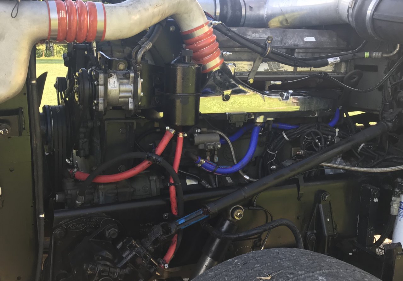

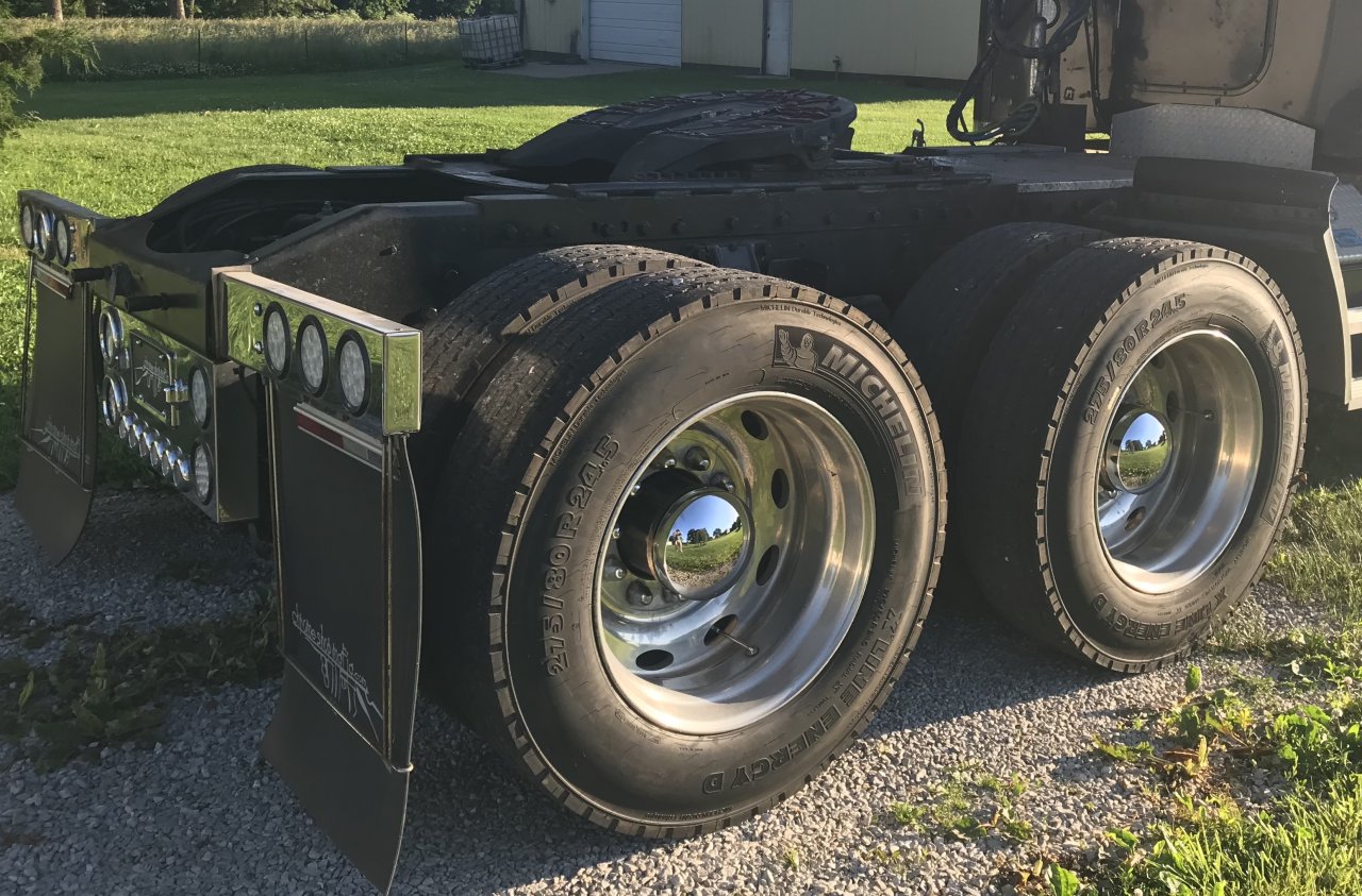

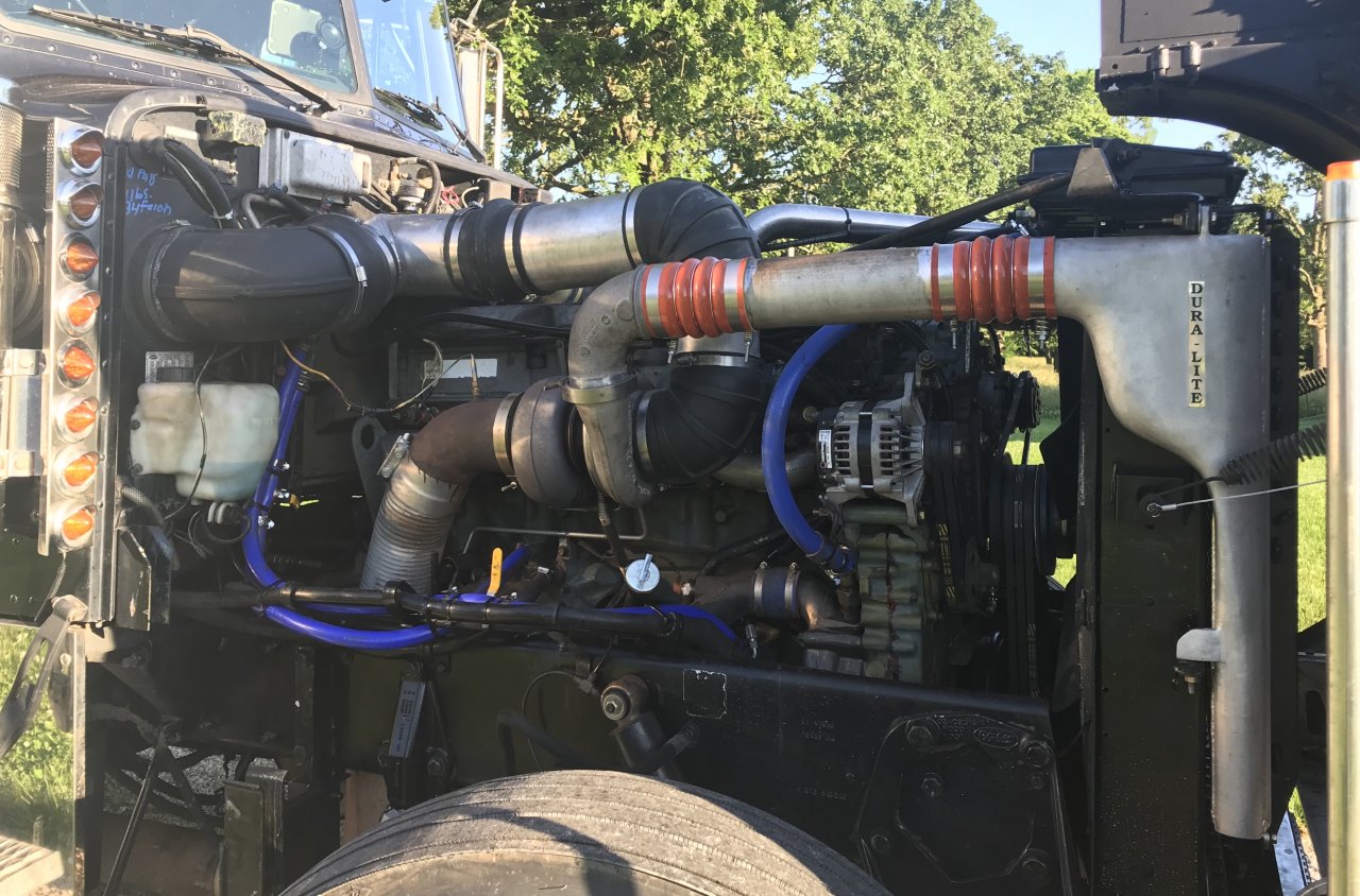

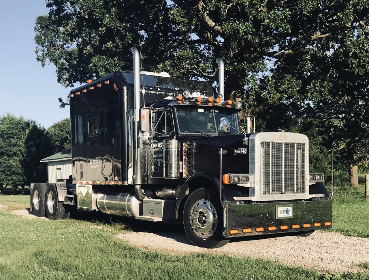

    After 3 weeks in the shop, the truck is finally back.
    Here's a rough list of the work.
    New CAC - Duralite.
    Recore radiator to 4 core.
    Stainless upper and lower rad tubes, new coolant hoses, fan clutch air hose, rebuild fan clutch, new water pump, thermostats.
    New hood pivots, bushings, cables. Weld bumper bracket, build supports, install bumper.
    Reseal front structure, new cam bearings, rebuild jakes.
    New 5th wheel, brake relay valve. Flex pipe to stacks both sides,
    Replace head gasket, replace #3 cylinder pack due to scoring. Injector O-rings.
    And a bunch of other bits and pieces.
    Total cost $14,715.
    We thought the oil leak was coming from the front cover. I said - I can buy a lot of oil for the labor to get all the way in there. Pulled the trigger on it anyway, to find that after it all went back together, oil leak still persisted. So - he didn't charge me the labor on the front structure job. Pulled the head and found the leak in the gasket. On the plus side, I'll spend less on cleaning the shop floor now.
    Now I'm all dressed up with NOWHERE TO GO.
