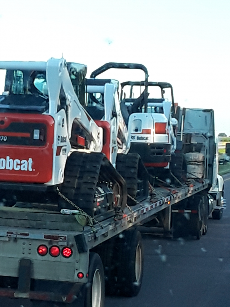

    If it was centered on the trailer, 5 chains should have been more than enough.
    I wish i knew the whole store, and how he had it chained.
    I have hauled fuel tanks to the bush up some terrible roads, so the loggers and miners had fuel tanks. They never move at all.
    Big tanks, I throw on 5 chains and go. So now am incredibly curious.

    saw this one yesterday.
    It was a Western Express.
    One chain and binder per side of each machine.
  6. D.Tibbitt
    21,628
    147,524
    Thats exactly the western express truck i posted about months ago outside chicago , had that same load and all his binders and chains were so loose they looked like they hadnt been tightened 1 click LOL wow i hope this aint the same driver, i guess they dont have very good securement training over there

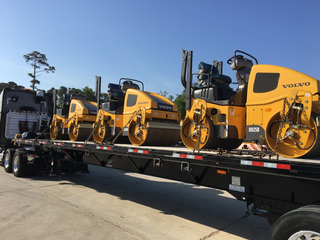

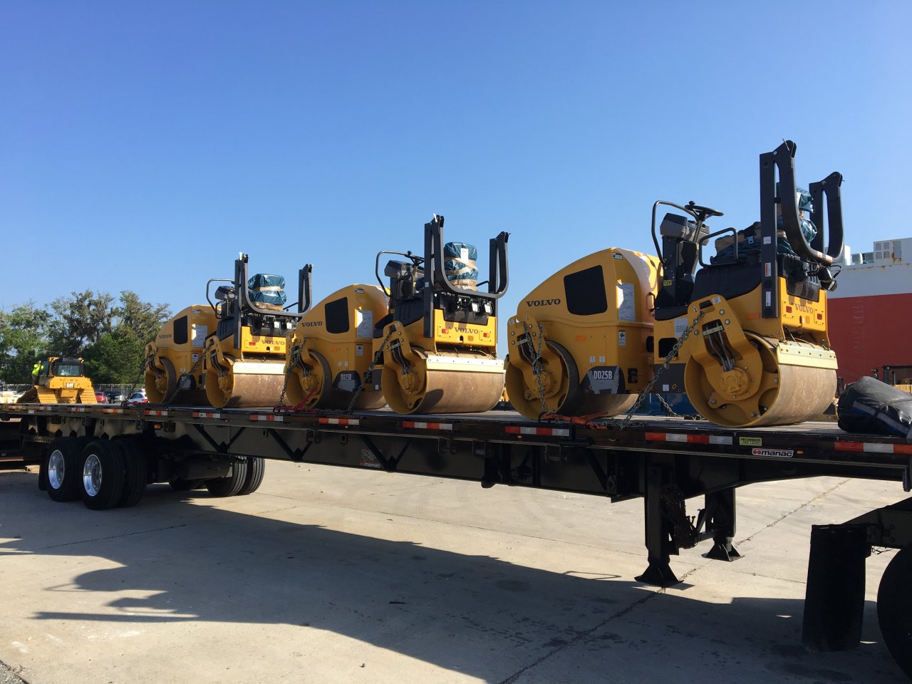

    I wouldn’t do it that way but it’s legal if the machines are under 10k.
    Actually that’s a lie. I would do it that way. Works just fine.

    Couldnt u just run chain from one side to other and put binder on each corner. 4 anchor points 2 chains. Or is that to much work. I never hauled skid steers but id imagine they have dedicated securement points
  9. daf105paccar
    6,564
    7,293
    Apr 15, 2012
    Problem is if 1 securement point fails all securement fails.

    I've hauled a lot of skidsteers.
    4 chains on the actual machine itself, and 1 over the bucket, for a total of 5. Maybe overly cautious for some, but never lost a load in 34 years so it works for me.
