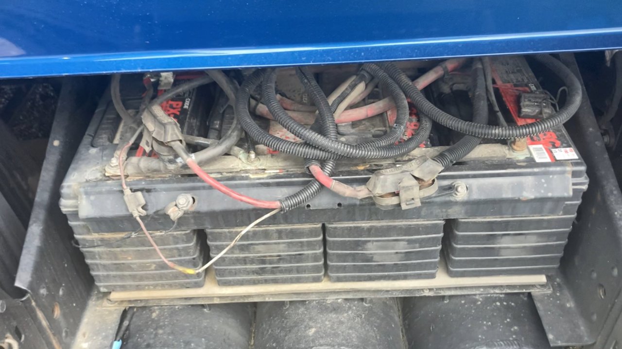

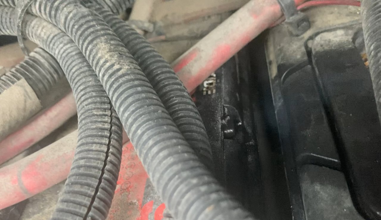

    We woke up with head aches and a strong chemical smell in the air. The APU was running all night charging the system so the truck had been off.
    there are 4 batteries and the second from the right is venting a visible gas (see how its wetting the right battery) and is hot to the touch. I turned everything off and turned the battery switch to disconnect.
    the good news is that we are parked at a truck and repair shop getting our conastoga kit installed so it couldn’t have happened at a better time.
    Now we need to find out what the damage to the repair fund is going to be….
    I assume its best to replace all four? :confused:

    I usually do, if you’ve got a weak battery, you’ll find it next.

    Yeah. Batteries are cheap, replace them all, especially going into winter.

    Yeah, I did when one went bad. Had the rest tested and found out they weren't long for the world either.
    Same with my air bags. One went bad and i figured they were probably all made the same day, installed the same day, and had all pulled the same freight.
    Sometimes simple logic will spare you from a road call.
    Like my old tire story.....TLDR, "dude, you're gonna buy a tire. Now whether you do it on the side of the road or at the tire store is completely up to you. But, one way or another, you're going to buy a new tire."
    Choose wisely.

    Yep. Replace all 4. As others have stated, you’ll have peace of mind, going into winter.
    Most likely, a plate broke and is touching the one adjacent to it, which causes a dead short. I just had the same thing happen to mine, early June, after bouncing across Indiana I-70.

    You handled it the right way. I would replace all 4, usually when one goes bad, the others are not far behind.
