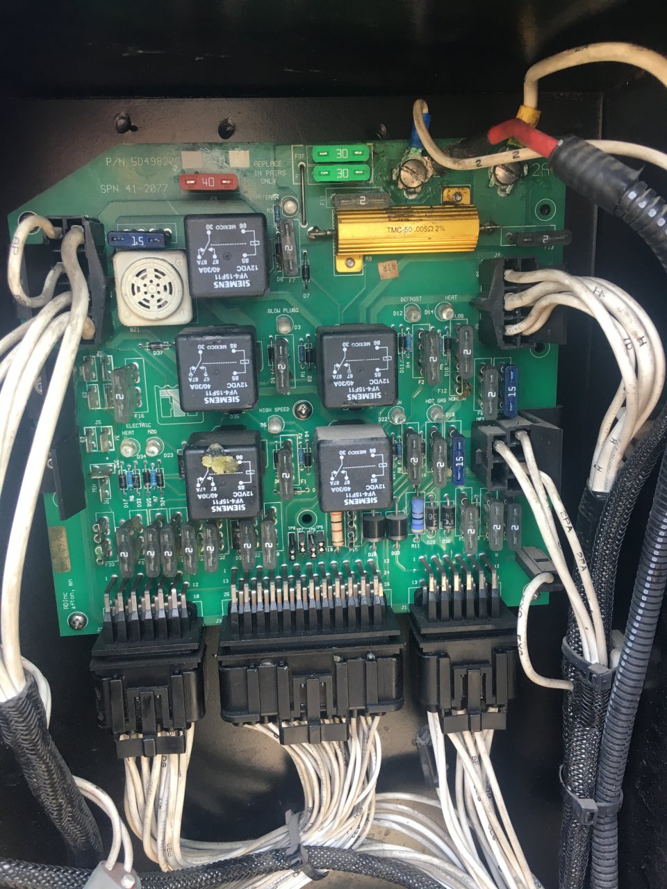

    My SB III R+ Starts and runs fine but in Auto start Cycle Mode the Starter stays engaged after the Engine starts.
    I have swapped the start relay and by passed the stater relay. Also replaced the Starter and still does it. Also have talked to A Thermo King repair and they are not sure what is causing it.
    Please help. Thanks

    Are you referring to this as the main board?
  9. Snailexpress
    2,654
    6,034
    Apr 28, 2014
    Rocky
    Yes. Is it some green on wire marked 2 connector?
