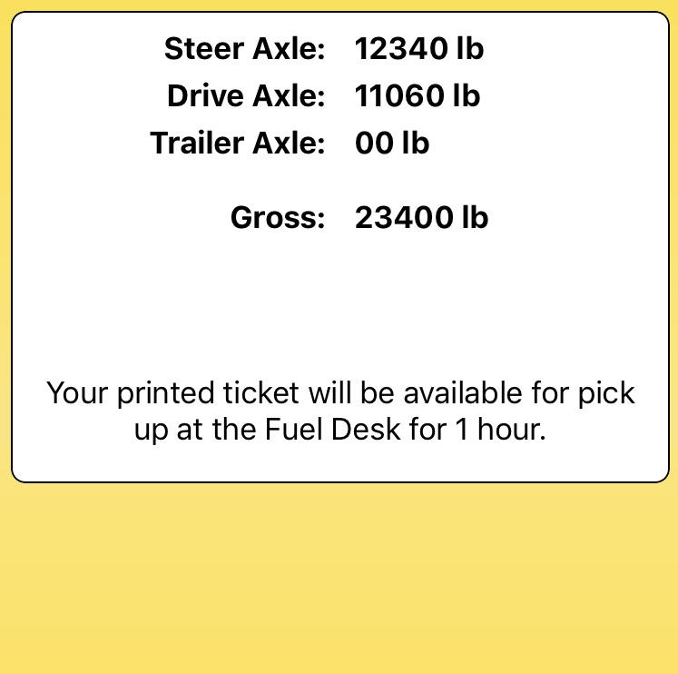

    We got day cabs with a lift axle and no lift axle, I’ll send both. On a side note we have a tri drive Canadian truck that’s pretty sweet.

    This is a scale ticket for this exact truck. X15 Cummins, double frame, 244” wheelbase.

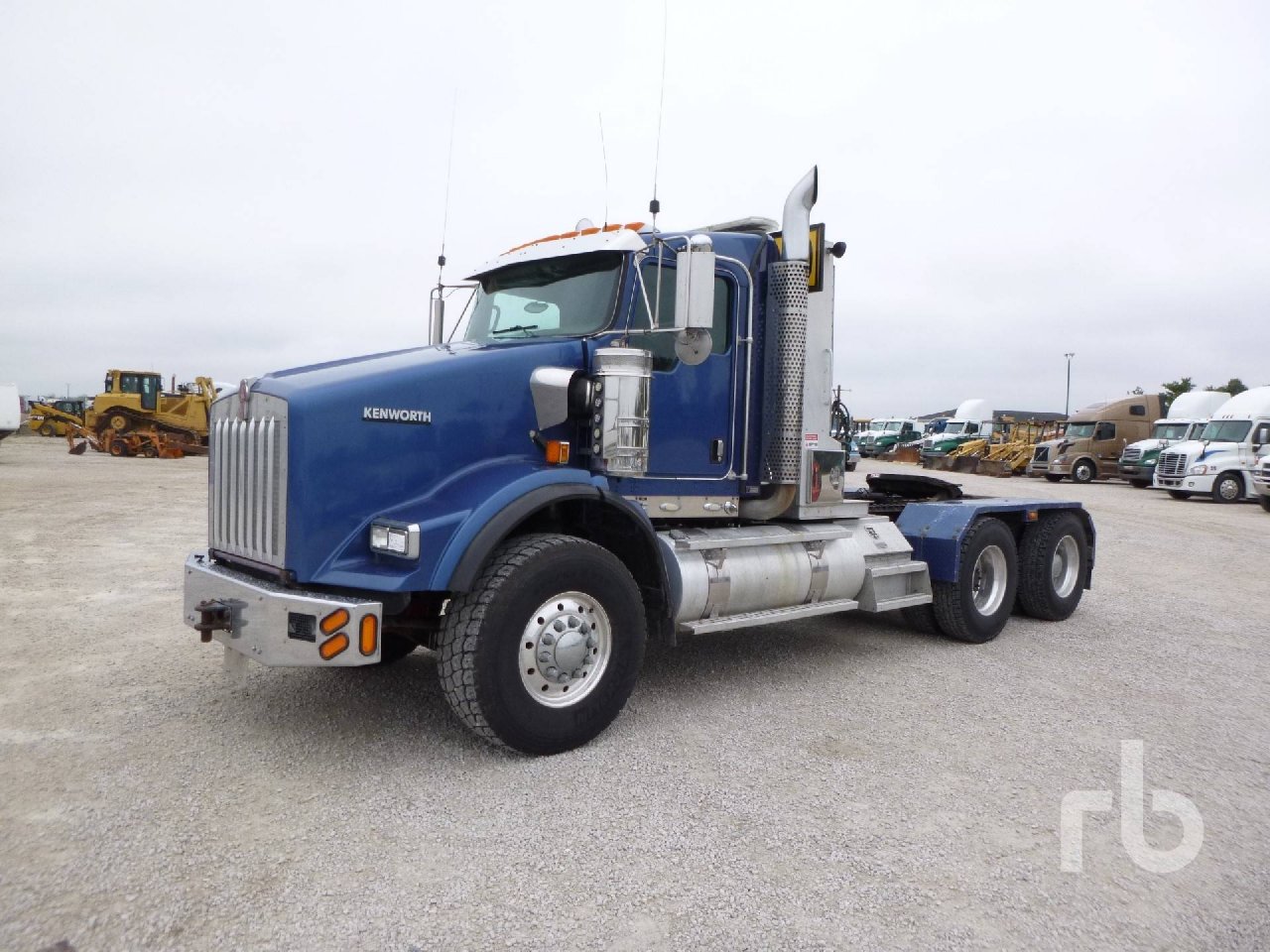

    I am not really considering

    @johndeere4020 , the truck I am looking at is a bit shorter and does not have a lift axle. I would guess it weighs 19-20,000?

    I'd toss a guess that this weighs in close to that with chains n stuff. That's a heavy spec'd three axle.
