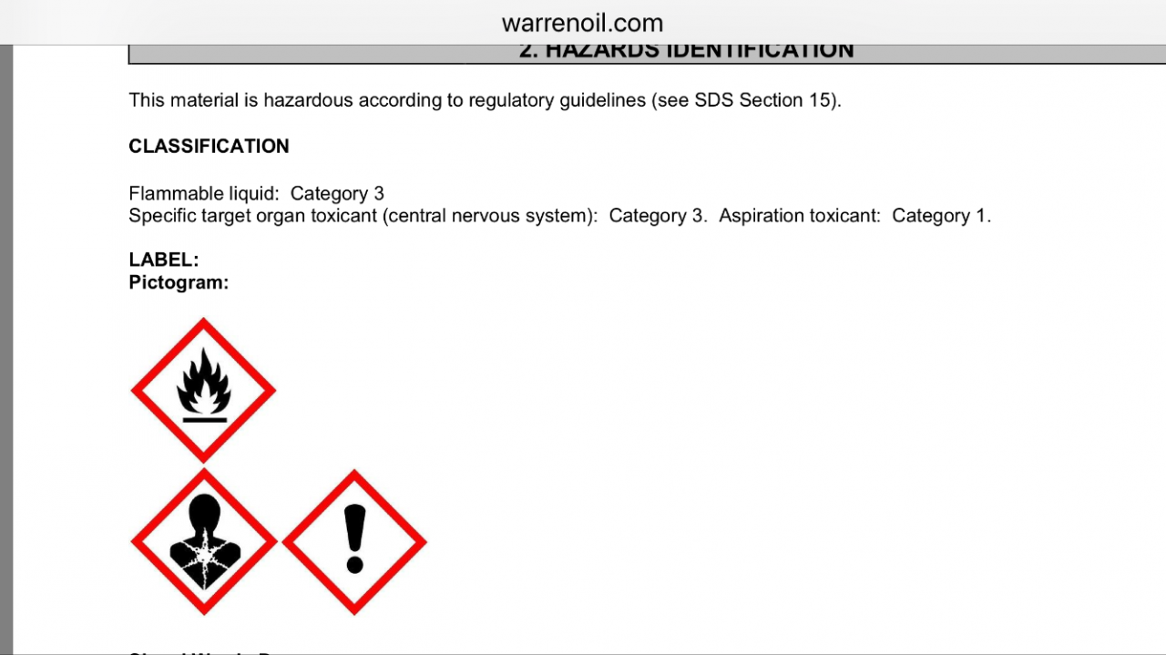

    Years ago, I had hazmat on my license. I dropped it at renewal time because I didn't want to mess with the hassle. Here's my situation. I know from memory (unless they changed it) up to a certain weight no placard required. I turned down a load because the load was BBQ lighter fluid. Something along the lines of around 1700 bottles of it. Lighter fluid wouldn't it fall under class III, but was I wrong for refusing it?

    Well, you know it depends on weight, but you didn't tell us what the weight is.
    (1700 Bottles x ?Oz/Bottle)/16 = Total Lbs.
    Total Lbs > 1001 Lbs = Placard
    Total Lbs < 1001 Lbs = No Placard
    So if each bottle had 9.4 Oz or less you'd be OK. Else you would have needed placards and a hazmat endorsement on your license.
    Note that you still have to have the periodic general hazmat training to haul any hazmat.

    They had the bills printed out. If I read it correctly, 21 pallets(I don't know how many per pallet) of boxes with 12 32oz bottles per box.

    I mean, I looked the bol over, saw the number of pallets, I guess what caught my eye was it said a net weight of a bit under 37k for the load.

    You can't calculate without numbers. But I can pretty much guarantee you that 21 pallets of lighter fluid will be not only placarded, but bulk placarded.

    That's what I was thinking. It only showed the 21 pallets, the net weight of around 37k. I asked the shipper what the abbreviation clf was he said charcoal lighter fluid. I could see a pallet of it but he said that was the entire load, so I turned it down and left.

    No bulk placards unless the individual containers are over 119 gallons.

    Not true in my experience. If the weight is over 8,820lbs then bulk placards are required. I was informed of this rule while hauling 55 gallon drums.
