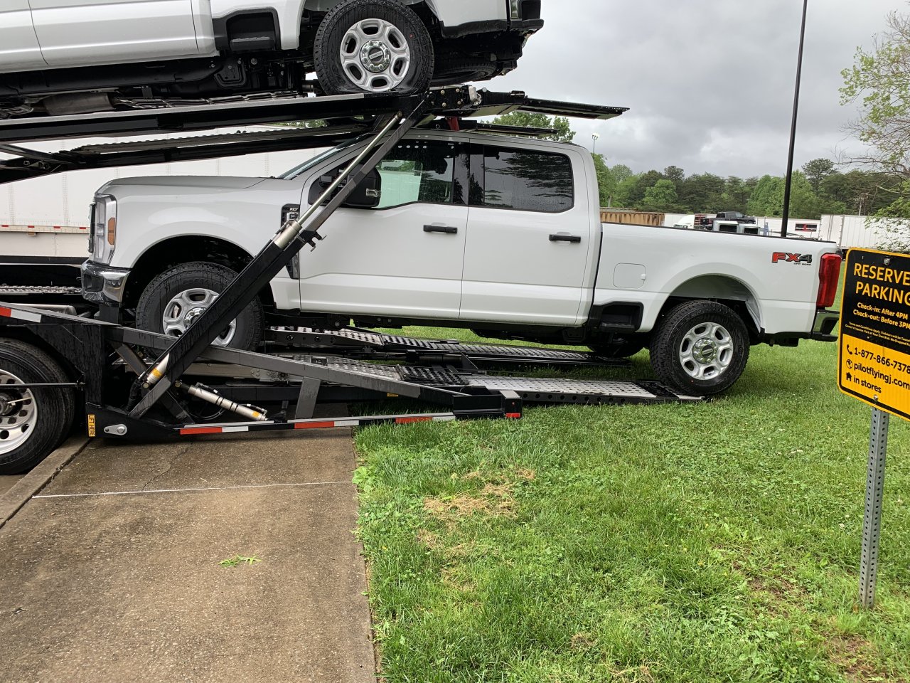

    How much is too much, I guess that depends on the officers discretion. This looks like 8’+ past the rear bumper. Is this normal? Just curious. IMG_8058.jpeg

    6’ from the light box is legal. I agree that it looks like 8’. I would be more concerned with damaging my equipment than too much overhang. His bottom rear deck is out so far that it will drag on every dip he hits.

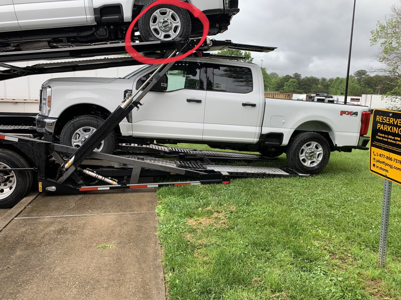

    This guy is clearly an amateur or severely undertrained. If he is hauling new vehicles I hope he gets cut off soon. The flat tire is really all I needed to see to call him an amateur. I would like to see a picture of the entire load. It’s likely a combination of one or all (not loading correctly, inexperience and too big of a load). @Hammer166 what is your opinion?

    Just an extreme example of the same crap we see everyday, there's such a push to be fast that most take every shortcut possible while lacking the knowledge to understand how out of whack their deck and axle losdings are. That and they try and load loads that we can haul out west no problem but will get you a bridge strike back East if you loaded them the same way.
    @kylefitzy, I'd put it to you this way, you won't see a carhauler load that long off the back, but you'll see a lot of guys who haul cars do it.
