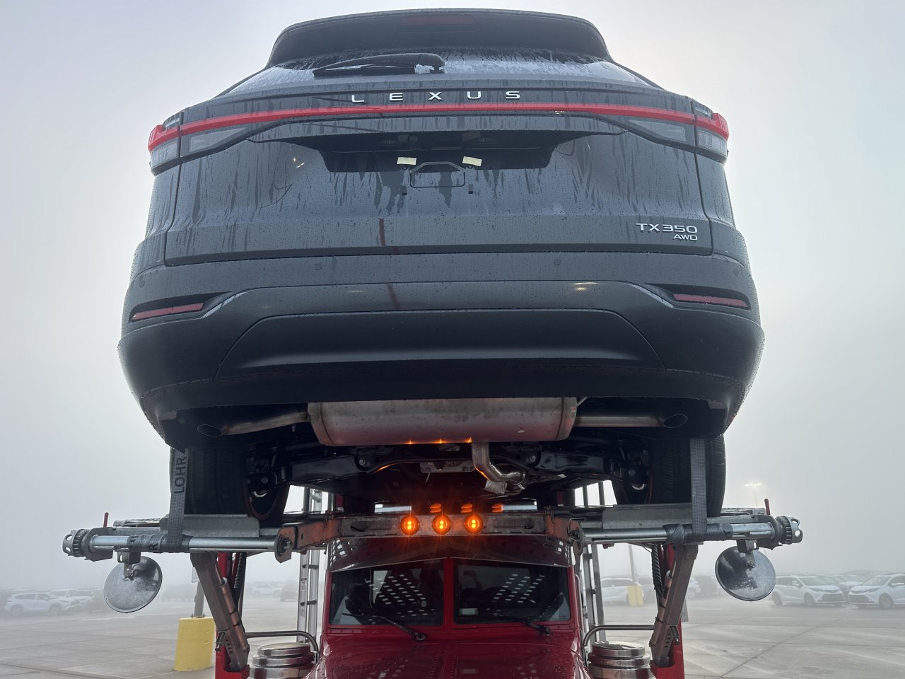

  9. Banker
    Banker Road Train Member
    4,038
    11,557
    Aug 19, 2012
    The Lexus is roughly the same height as his Traverse. He may not have a chop top like I do but it really shouldn’t make much difference on a SUV. I can run 14 on my route but could easily get this unit down to 13’6. IMG_4610.jpeg IMG_4611.jpeg IMG_4612.jpeg IMG_4609.jpeg
