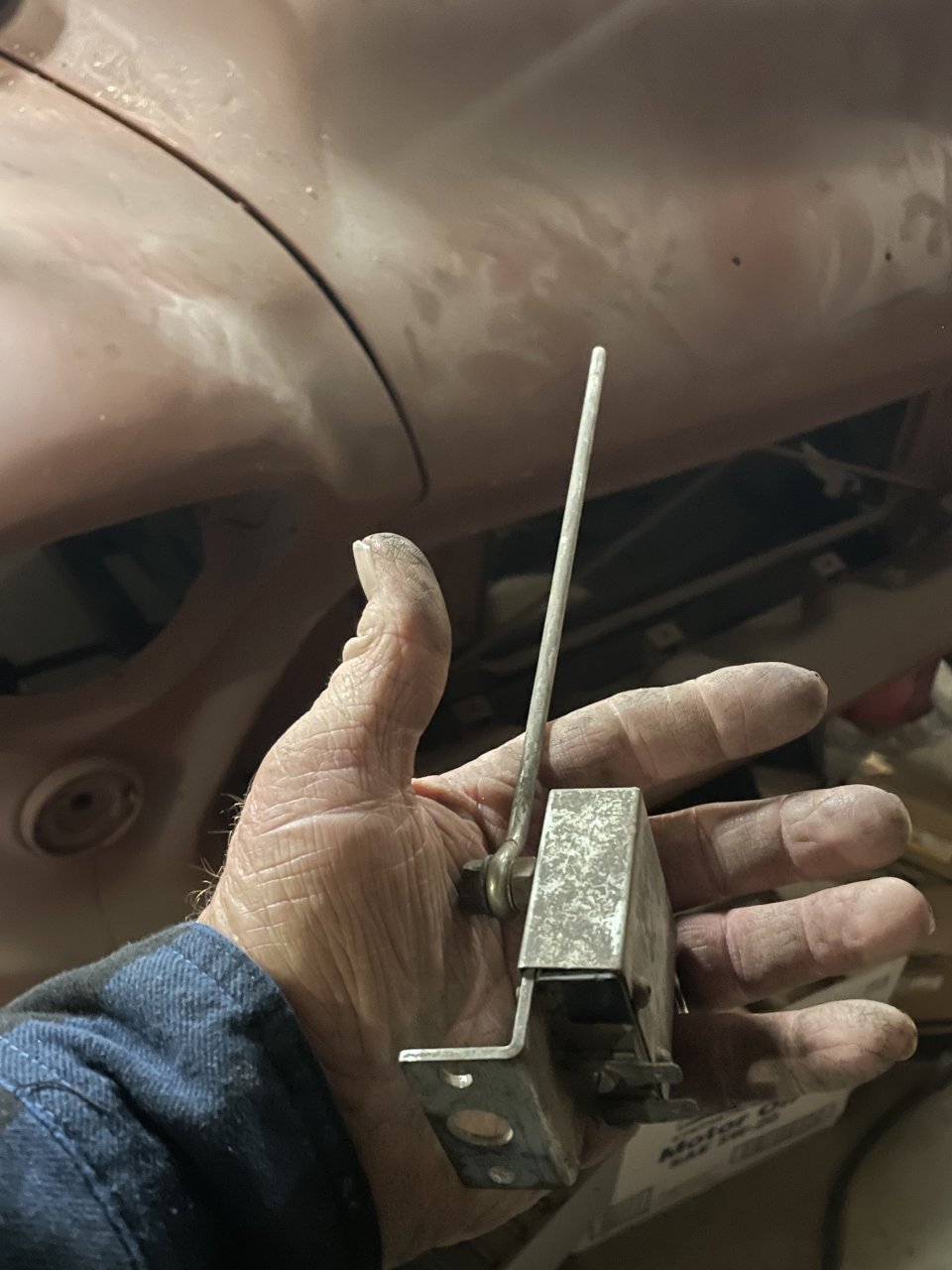

    Do you remember the old floor switch usually to the left of the clutch?
