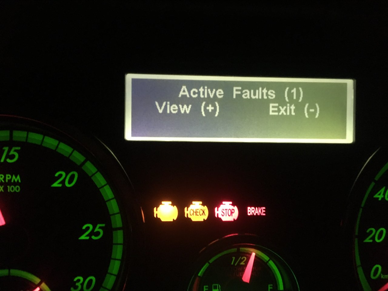

    I have some what a similar situation. I drive a 2014 Pete with a series 60 Detroit. When the engine is cold no problems, jakes work like supposed to. Once its up to temp as soon as i let off throttle Jake automatically switches to stage two and check engine light comes on and stage two is disabled as long as chk light is on. In the diag display for faults i get two: 1.) Aux I/O Circuit 4, and the other, 2.) Total PTO Fuel Message Missing. Has almost 400k miles and never seen the regen light or anything like that. Won't allow me to do a regen either.
