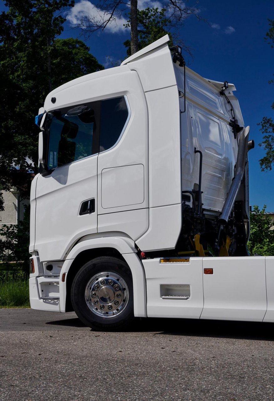

    Scania is introducing long premium cabs for increased comfort. The R and S series cabs can now be specified with 270 mm extra length.
    “Scania raises the bar for premium trucks”, says Stefan Dorski, Senior Vice President, Head of Scania Trucks. “We will blend some of the capabilities from our Scania CrewCab into our premium cabs in the R and S series. By doing that we add generous space that brings extra comfort and opens up for a multitude of creative solutions”.

    this is not serial production but comes from company laxa special vehicles (they make special cabs and chassis conversion for scania), scania do have some share inside. from scania colleagues i can heard they are lazy and dont want to do anything unless they have extra high profit or high numbers.
    good thing is that they make cab from scratch, using panels, galvanize it...
    it is not finished cab than converted, so this way there wont be rust and no wait time, volvo does this for years, in last series on same way to cut costs (cab extension hided between rear air deflectors)

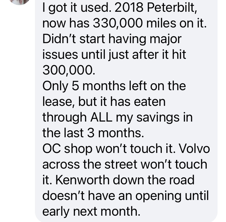

    Typical story here…….
    A06AEEFF-6D2A-49FF-B79B-B636BA84368F.jpeg 9CFD39E2-8799-4742-BFF4-67F531FCF740.jpeg
    daf105paccar Thanks this.

    Seems like Kenworth have big issues with their service network. Waiting a couple of weeks for replacing an adblue module or sensor seems ridiculous.
