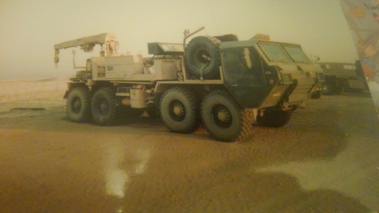

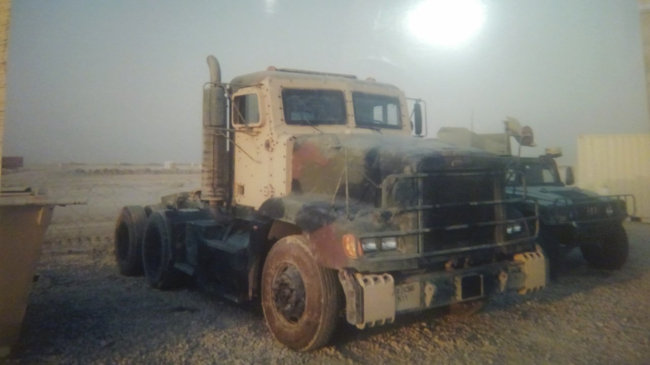

    Used to hate getting stuck behind HET's (Heavy Equipment Transporters M1070) on the MSR's in Iraq. Top speed for them was 48 MPH. My company ran M915A3's and my wrecker was a HEMTT M984E1, so we could run 67 MPH. If I recall, the Silver 8V92 was cranking around 2300 RPM to maintain that speed. Here are some pictures of pictures of the trucks. KIMG2865.JPG
    This is with armor, didn't have that first tour.
    Wrecker I ran. Slept many of nights under the stars on a medical liter spread across the toolboxes.
    Motorpool office entrance improvements. Talk about us, walk without us!
