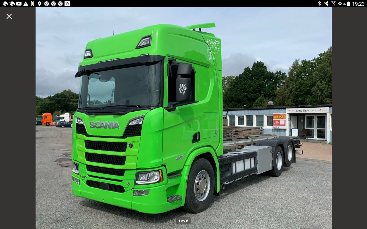

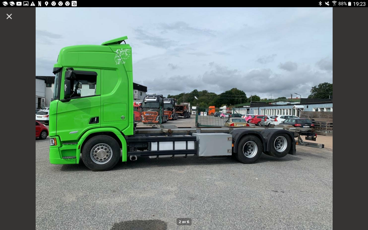

    The Hulk or Kermit the frog? I haven't named it yet. But it's my new truck. Boss gonna send me 9 hours by train to get it home.
    The seller is going move some airtanks and mount sand spreaders. Then we take it home and move container locks forward so it will fit 7.45m container. And install microwave, CB radio and som lights.
    2018 R580. 420000 km. Norwegian import=full spec. Or as you may say:all the bells and whistles Screenshot_2021-09-30-19-23-24.png Screenshot_2021-09-30-19-23-16.png

    this cab is right for this application.
    mirrors are too big, volvo is best in this.
    here people buy mirrorcam for other reasons than big mirrors, it is kind of must have.
    i think entrance, even in wide cab with flat floor is far way better than in volvo.
    plastic on steps does crack, it is possible to buy stainless steel ones
    as for webasto smell, i am not informed about this.
    what i dont like about this cab is relatively small fridge, larger one could not fit below unless they raise bed upwards.
    on right side air intake that goes behind cab to middle of engine, take 4-5inch of cab floor, this make right stowage compartment bit smaller than left side. this part of cab floor make entrance for passenger bit harder than for driver.

    i would call it police magnet.
    this bring color cant be unnoticed.
    so it is now c782 and you are going to replace subframe forward to suit c745 and cut overhang?
    did you make axle weight calculation, this 185mm could result in front axle overload. i guess you have 8t front axle.
    how good is condition considering it is nowerigan truck?

    when scania have twin tired tag than drive axle has only 2 bags, only version with steered tag axle can (optionally) have 4 bags on drive.

    scania offers 3 hypoid different differential for for 6x2 trucks with v8 engines. sometimes you can combine them with 2 different axles.
    this one would have 28660 lbs drive axle and tag 22050.
    in legal way probably reduced to 41900 lbs.
    when it is winter in norway they lift tag axle to get extra pressure on driven axles, on tractors this value goes to 42k on rigids trucks like this one up to 48,5k, depending how it is loaded, wheelbase etc. this is where you have to very careful as you has very little on front axle, and thereby no steering

    for normal trucks scania make 22k front axle, for mining trucks 26.5k
    this one probably has 17,6k
