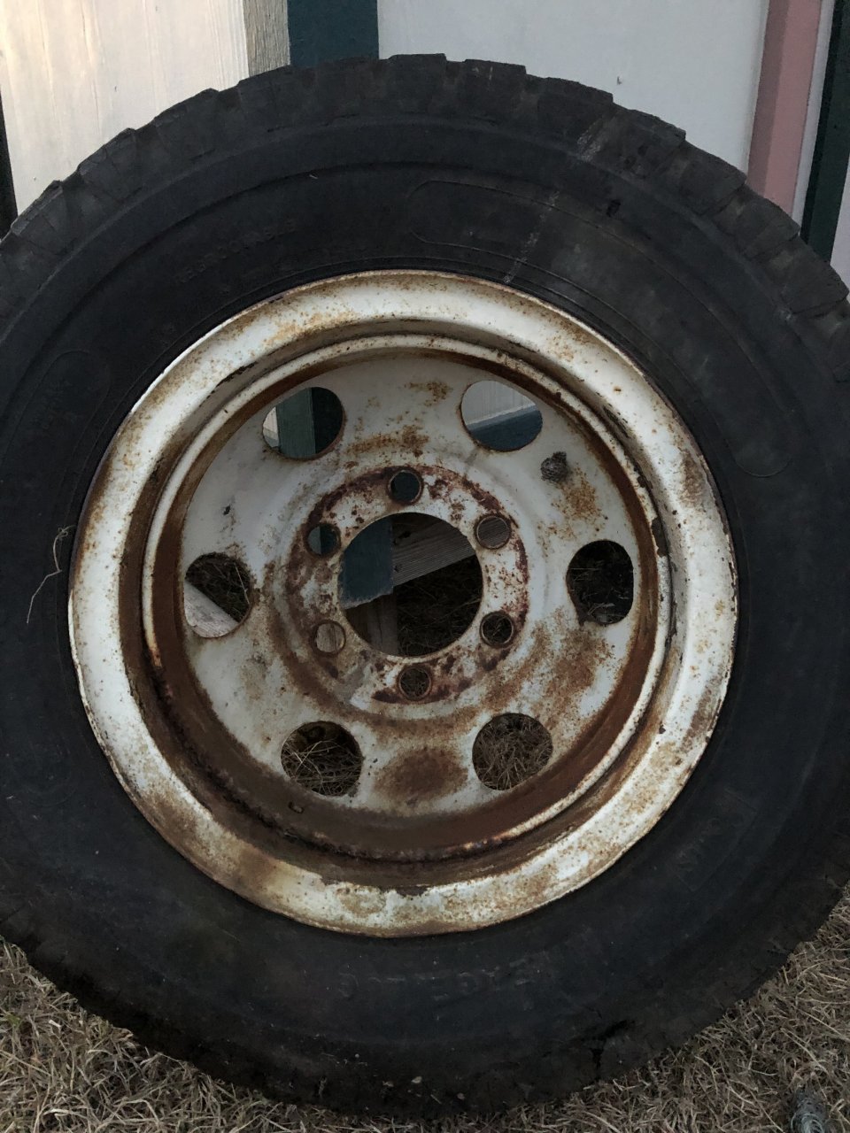

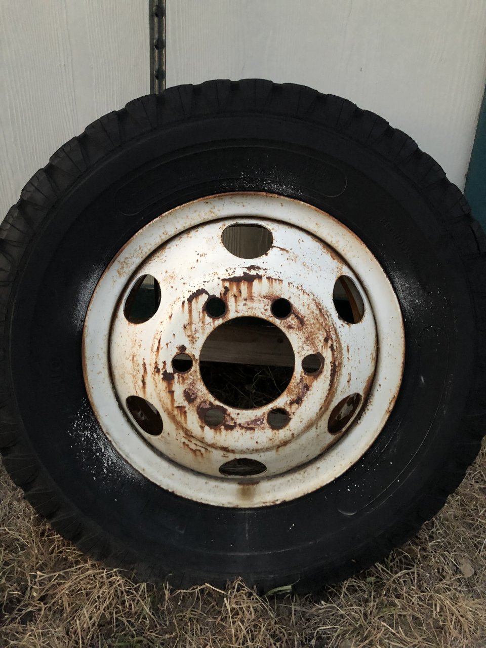

    Those are split rims. Inner went flat on a deer shed. The adapter that the outer bolts to shattered. I don't know how we would change them if the weren't split rims. Tires are about 900 lbs each, so are the rims.

    Real Split rims were made by Firestone and were the dangerous ones. They were never made in anything bigger then a 20”. There were two halves of the wheel clipped together in the drop center. Solid Beads, No lock rings. They were the “widow makers” i have one in my collection. All other tube type wheels were lock ring. Both Budd disc and Dayton Demountable types. There were two piece lock ring wheels which were usually built by Goodyear. Or 3 piece lock ring wheels which were the Firestone and Alcoa type.

    These are the Firestone made “widow makers” true split rim. See were the two halves go together were the hub or brake drum would be. Any corrosion made them impossible to click back together causing the booms of legends. 50-50 chance of it holding together while airing up. Lock rings were 99% safe if a cave man didn't work with them.
