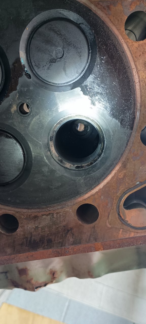

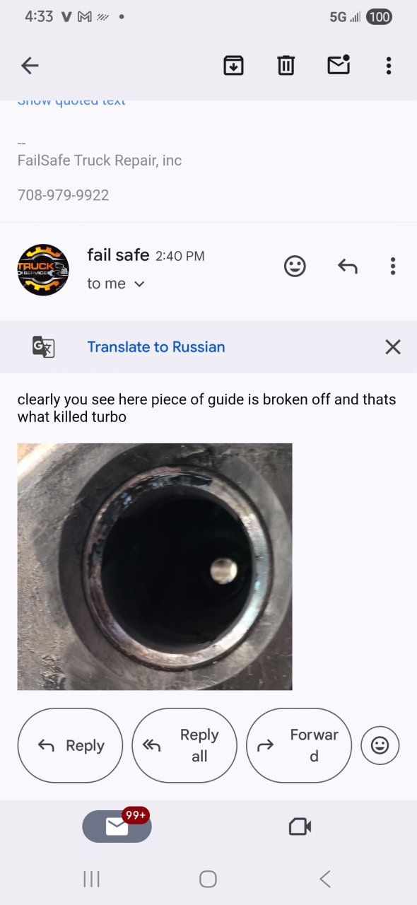

    In response to my objections, the shop sent me six photographs, claiming this proves the turbo was damaged before they started the cylinder head job.
    So, I now have two questions for the respected mechanic community:
    1. Can these photographs be considered reliable evidence that the turbo was already damaged before the shop began work?
    How conclusive is this? Would you say it’s clear proof (e.g., 100%), or more of a 50/50 situation? Or does it seem unlikely the turbo was previously broken?
    2. Based on the photographs, is it possible that the cylinder head didn’t actually need to be replaced at all?
    In other words, could this have been just a problem with one injector or one valve, not a whole head replacement?
    To me, the pictures do not clearly show cracks or serious visible damage to the cylinder head.

    Your truck had a valve seat come apart. That means that the metal from that was sent through the back of your turbo and effectively it’s ####ing junk. End of story.
    Now it gets tricky here because where that metal goes out through the rear of the turbo may not affect its calibration. And no shop any where on earth should have put that back together without a turbo. But end of time it does need one and it’s on your dime
