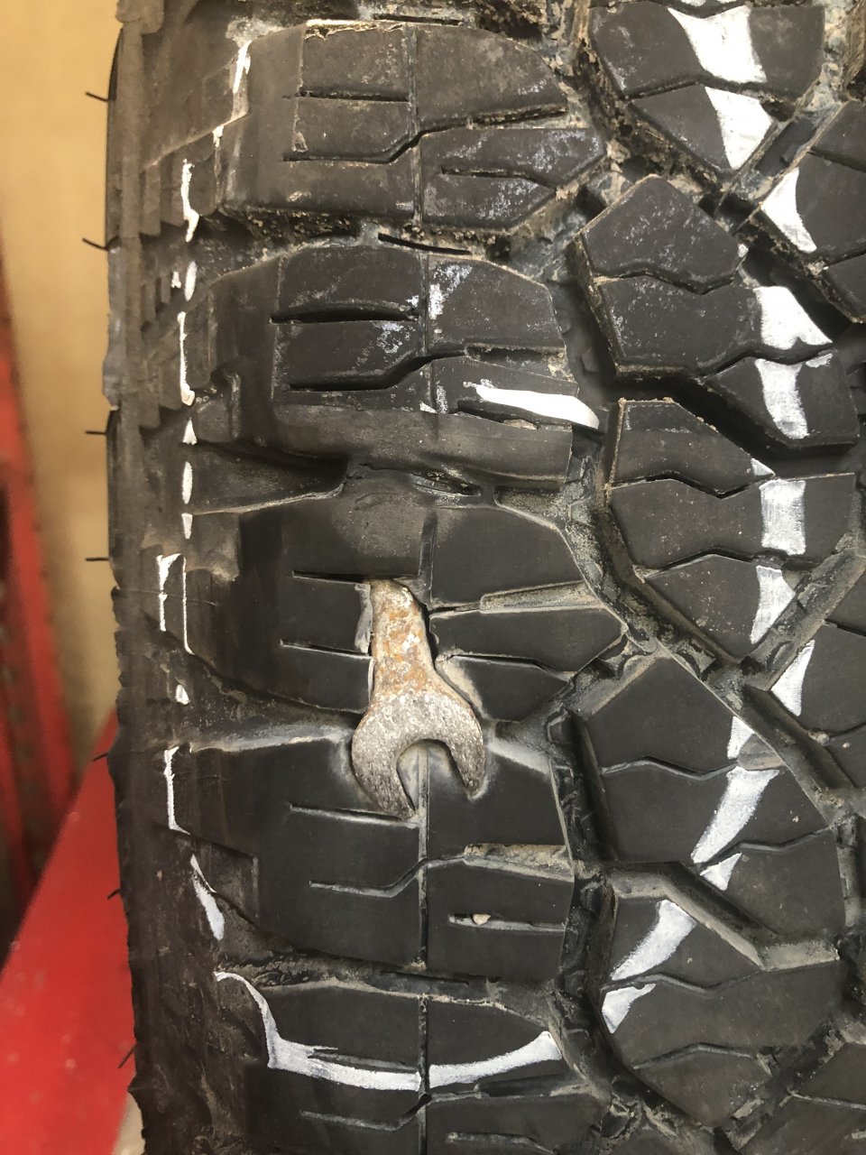

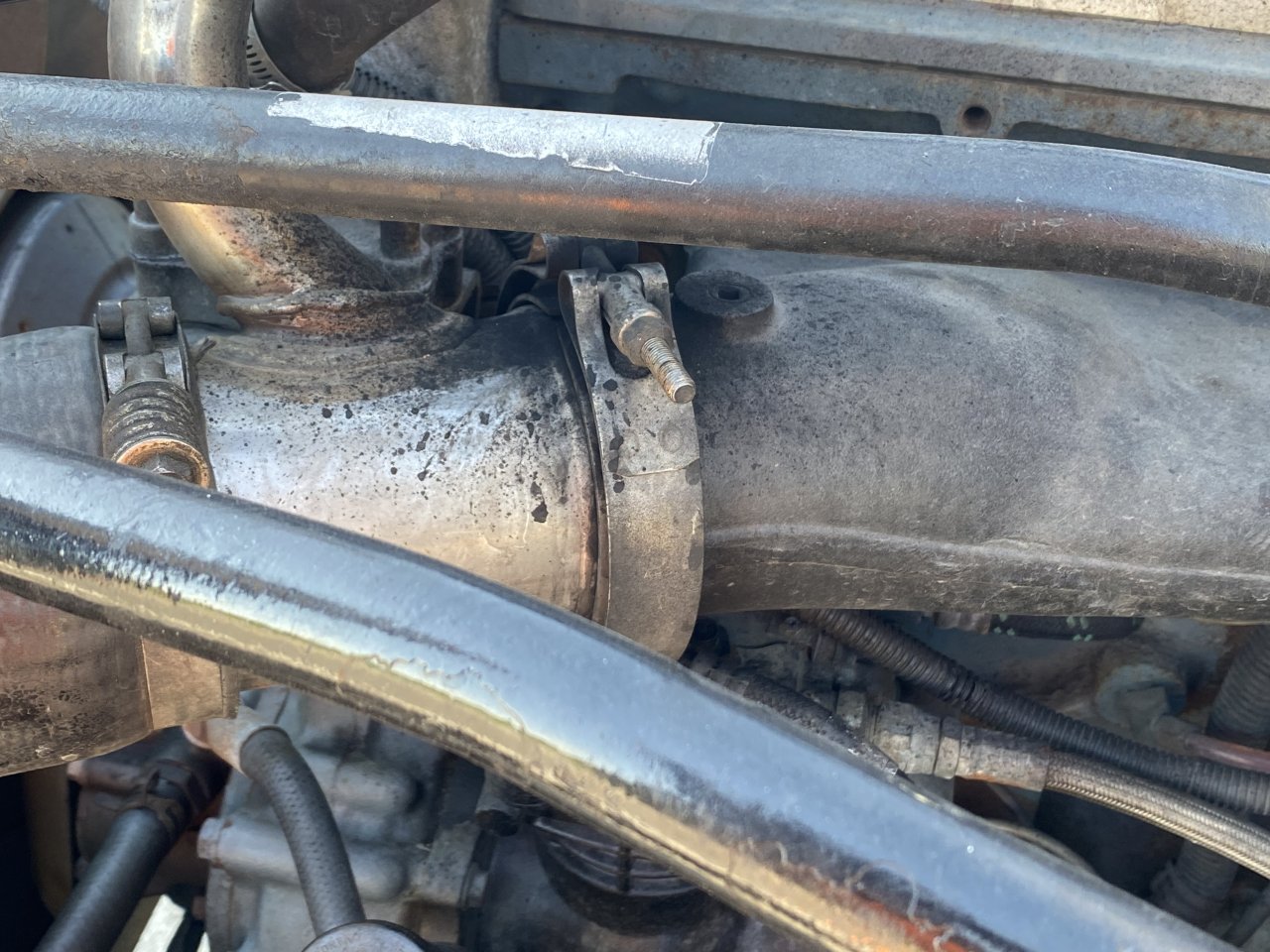

    While I gotcha. Would you say this is JUST a loose clamp? Anybody know what that silver piece is and what is its primary purpose? Thx!
  10. SmallPackage
    5,813
    18,631
    Dec 20, 2019
    Marion Texas

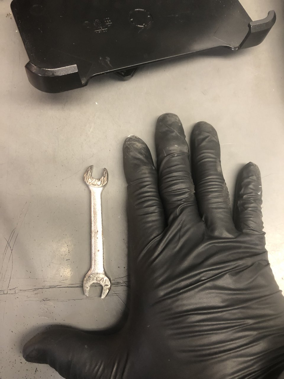

    Looks like there was some foreign material that got molded into either the tread itself or between the last steel ply and tread rubber. With the pressure of driving on it and the tread wearing down it opened up the cavities. This is a manufacturing defect and should be covered under workmanship warranty. Foreign material can be anything from dirt, air, scrap pieces of rubber or cord, and tools. Yes. I have seen whole combination wrenches or screw drivers molded in tires. Lol.
