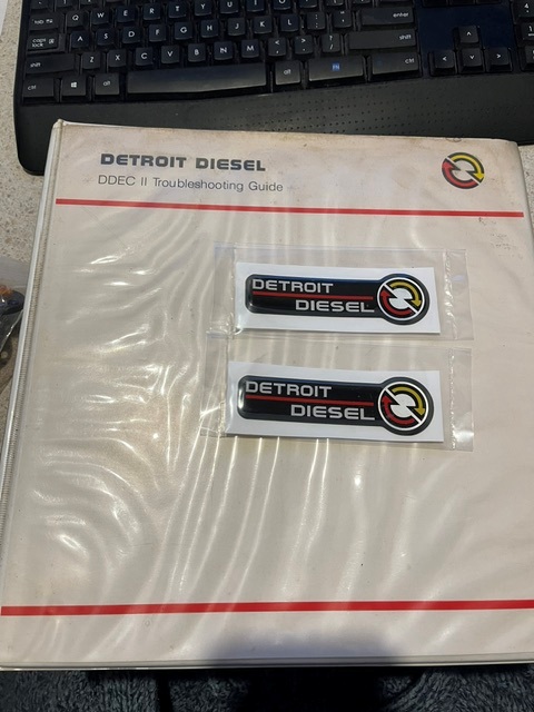

    Also had one of the manuals show up and some trim decals for when its all done. Classic ebay though, 3 decals left but now there are 10, and to scabby to adjust the price any to help with international freight.

    workshop manual, owners manual and electrical manual on its way. Koni shocks on their way but as always on some backorder.
