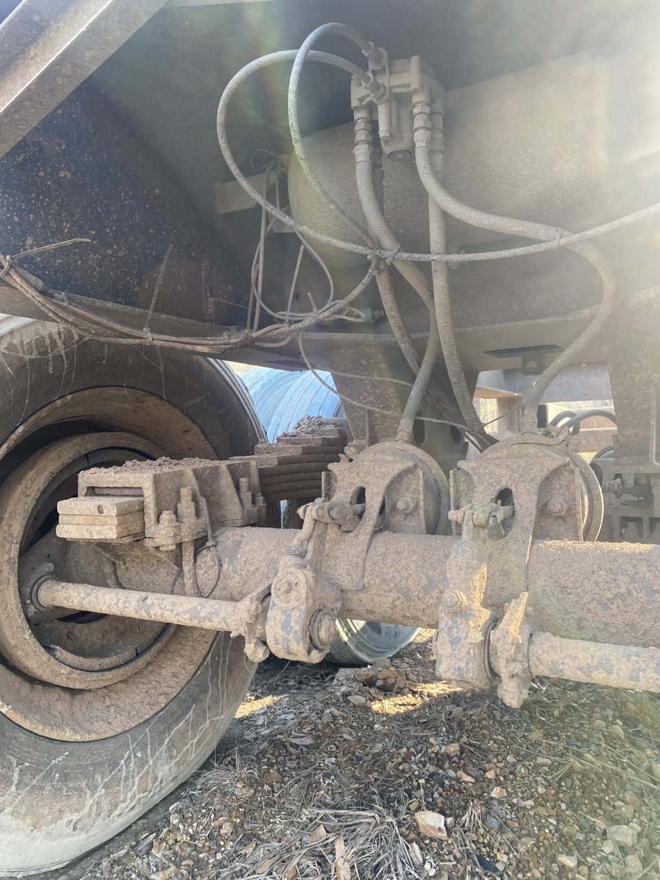

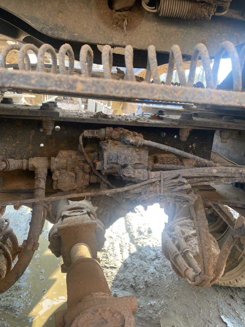

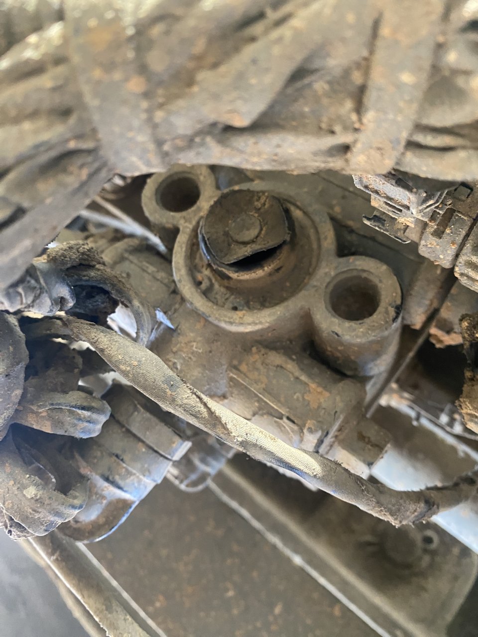

  6. Leonard1983
    Leonard1983 Bobtail Member
    13
    1
    Sep 28, 2023
    Here's pictures of the valve under the fifth wheel and the break pods under the trailer. The second picture shows where the air is coming out. I pushed the red button in the truck and pulled the jimmy bar and no air is coming out of the pods. Air comes out of the valve faster when the foot brake is pushed in.
  7. Big Road Skateboard
    7,179
    40,702
    May 2, 2021
    If air isn't leaking with only the yellow button in, @kwswan said, probably a trailer brake chamber.
    With red button in, pull your blue air line and see if air is coming out of the trailer gladhand
    Oxbow and kwswan Thank this.

  11. Rideandrepair
    17,573
    56,928
    Aug 8, 2015
    I had to change mine once. Only the valve portion, not the part with abs wires running to it. It wasn’t expensive. That’s all I remember.
