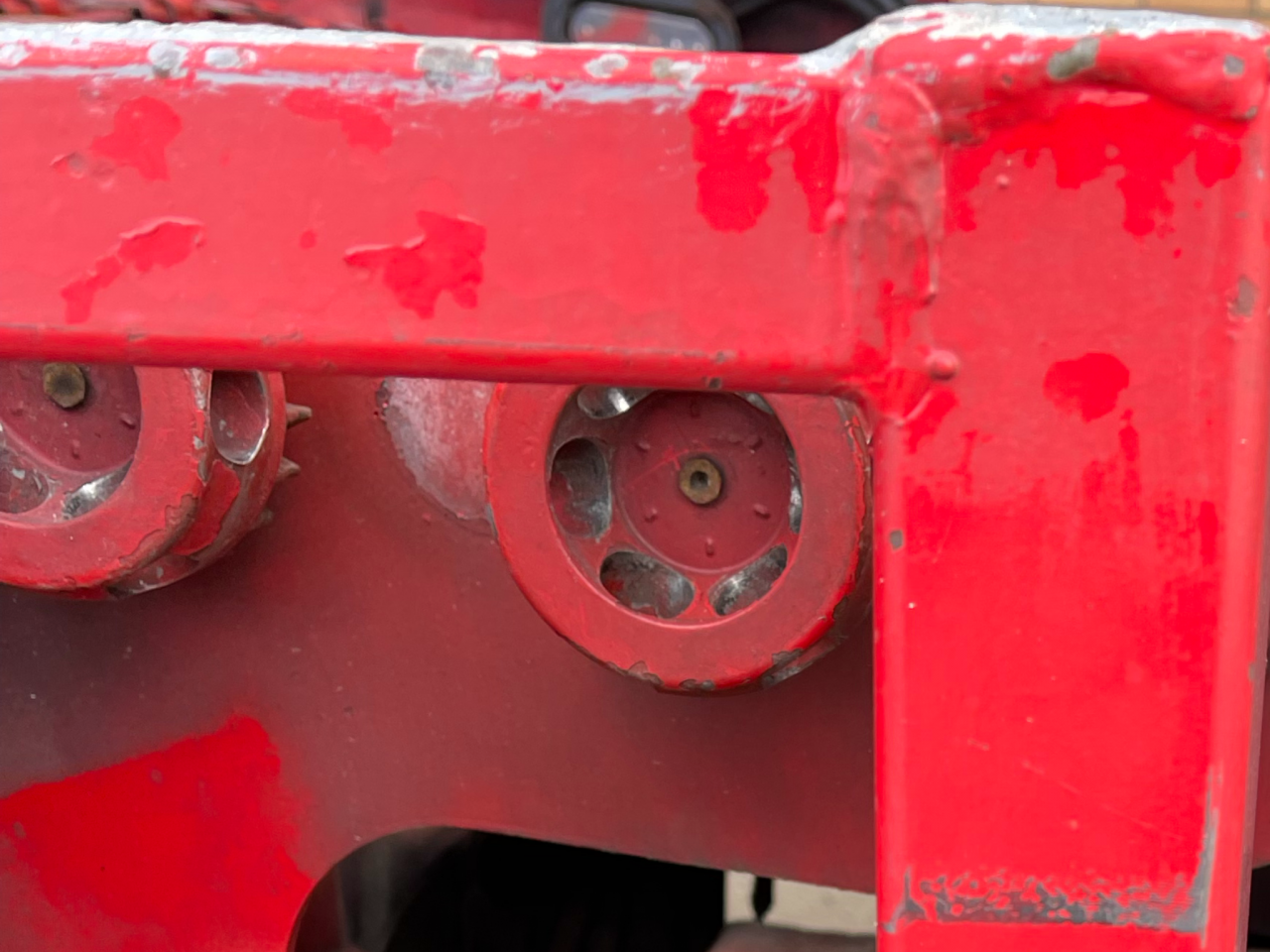

    Quickspinz do have grease points. You remove the plug with a very small Allen wrench, install a grease zerk and grease and then reinstall the plug. You can’t leave the grease zerk in the Quickspinz as the tie down bar will not insert properly with a grease zerk installed. IMG_0887.png

    Did they go back to the cap screw? I know there for a while they had the little rubber gasket for the needles. Either way, don't over grease them or you will hate yourself for 6 months at least.
