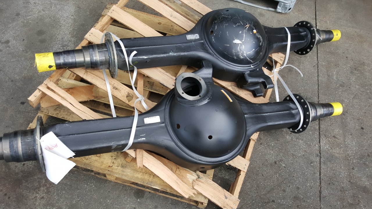

    If your axle broke , you are lucky to be ok, be careful could have hurt yourself and people around you. This is the risk of driving old high mileage truck, I had tcs fault few years ago on my last truck well over million miles, took it in a good shop, they inspected measures the axle, and found bearing excessive movement spinning and chewing axle spindle . Soo, they couldn't tighten the bearing and ordered these new axle housings new bearings, but was more expensive solution .You can call axle surgeons to inspect it, or similar axle repair services and weld new spindles if needed perhaps new bearings,it cost about 4-5000$ for all 4 drive axle spindles. I wouldn't drive it like this , don't ignore tcs faults , can indicate one wheel is spinning at a rate it shouldn't, yes most of the time are glitches bad abs sensor wires but can signal loose bearing or something more sinister and dangerous at the end of the axle/hub.
