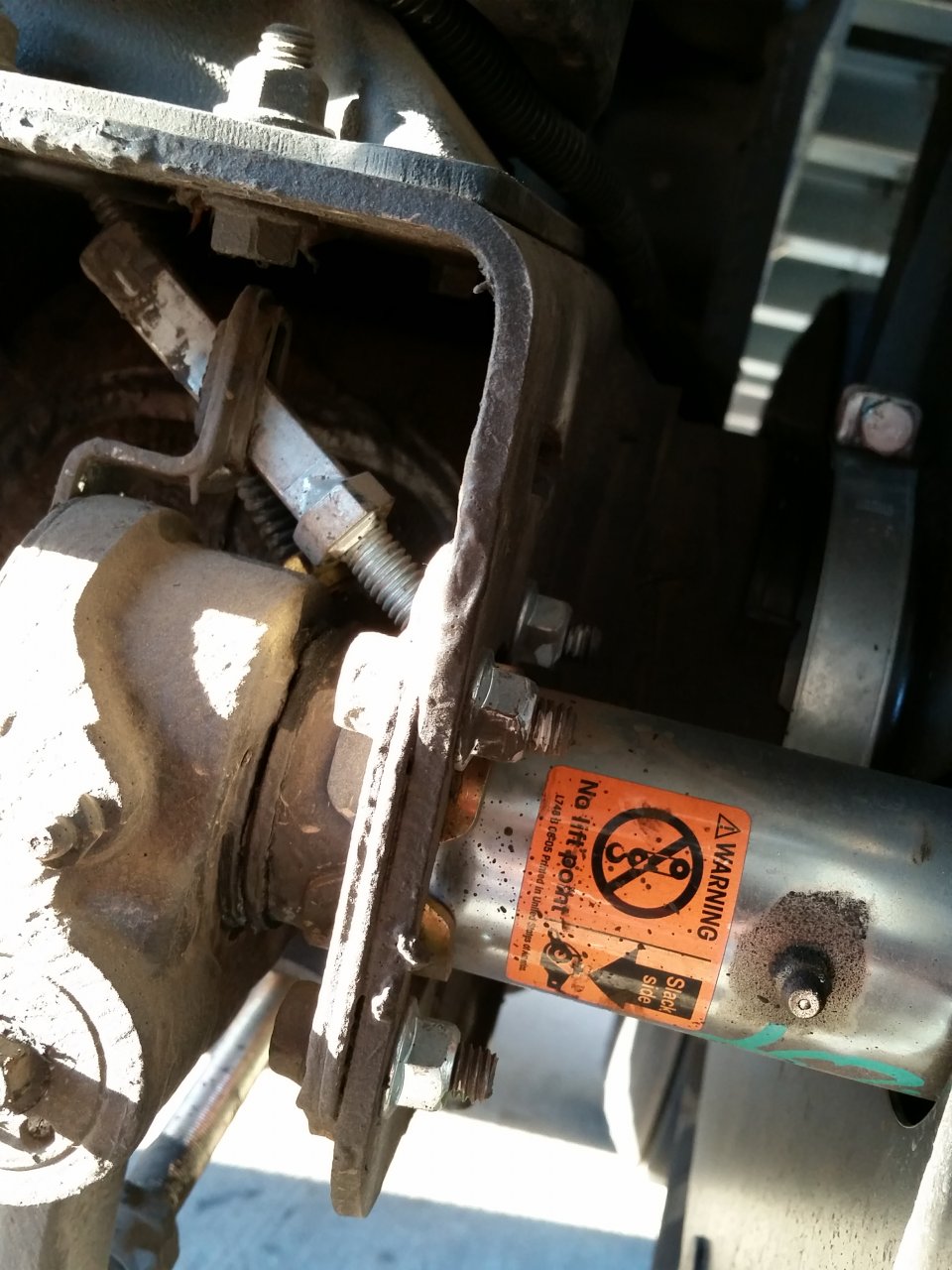

    This was found on a brand new trailer. The nut was missing on both sides, both slack adjusters weren't working.

    Had that happen to me on brand new compartment gas tanker. Coming back at 4am for reload in the rain,
    hit the brakes for a red light and jackknifed when trailer locked up. Nobody inspected the tank when it was delivered to our yard. Luckily, there was no traffic and no one was next to me on the 4 lane. All the brake components were loose and it cammed over..
