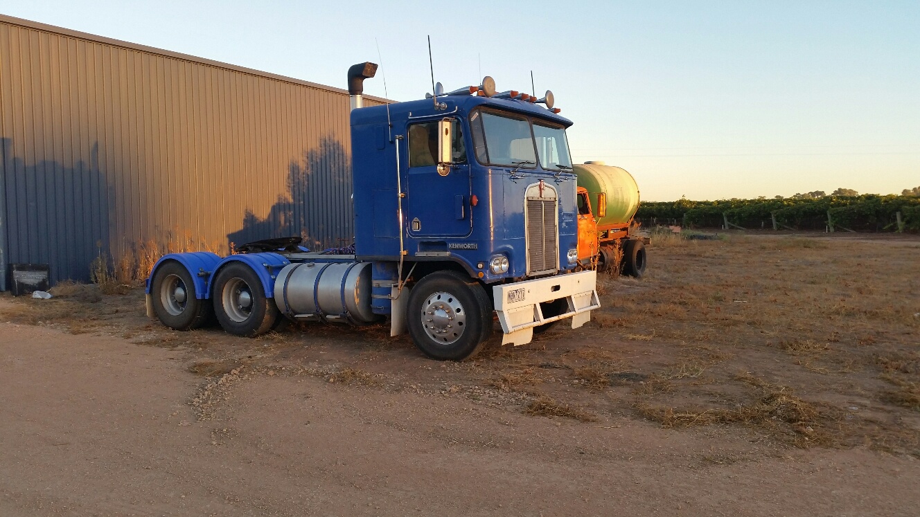

    Got a 2013 DAF which has way to many Paccar parts that attract way to much Paccar tax. Its also up for a engine rebuild at 60-80k AU, and the ZF auto management which is linked to the brakes is demanding attention. Then on top of that as much as I replace parts with my donor truck, another issue seems to pop
    up. So its got me thinking about reliability, costs of repair, and what's needed for the next 10 years or 1 million km.
    I hall 42.5T off a mountain with narrow winding roads that are not in smooth condition and can see 16% incline. So a cab over has merit for corners, especially one with the steers as forwards as a K series.
    I have thought about buying a new truck but it puts me more in the control of companies. I'd rather distance myself from that and telematics technology that comes with it as far as I can. I am an owner driver and emission restrictions don't exist where I live.
    So has me thinking of a 1977 K100 (K125 Aus spec) Kenworth with a 12.7lt Detroit 60 series 430hp DDEC11 powerplant. I don't think that motor is original but that doesn't matter as I would like to rebuild it. Can anyone tell me the pros and cons of a 1987–1992 DDEC II motor.
    I'm also a lazy driver, no gears for me. I've had an Allison 6 speed auto, like proper auto, in another truck in the past. It seemed bullet proof compared to this automated manual stuff driven by actuators, modulators, and ECUs. I think to cope with the load and incline a retarder would be a practical addition. . Again like to hear pros and cons to the idea.
    Of course it would be good to convert it to a fully air sprung cab. I half though or removing the system from the daf and see if it can be retrofitted, or something from a 200 series? . Something fully floating but also hinges. Any ideas on such kits be welcomed.
    I do like the simplicity or Airglide or Hendrickson suspension, but it doesn't get much simpler than the old torsion bar. Would love to hear experiences of set ups on poor roads. Think an upgrade of the steer suspension would be a must, the ol cab over rides like its sits on the chassis, because it probably does.
    Any I'm making enquiries into one I've had my eye on for a while. Reckon it can be done?

    I have a DDEC2 and I love it! It's set at about 500 hp, and the loads don't feel as heavy as they are. Up here there are few who know how to tune them. I don't know what it's like down under. Obviously I'm saying this as a driver who hates driving autos, and that's in cars too, the power band will not work with a 6 speed. Heck, they barely work with a ten. 13 is the way to keep it happy.

    You shan't be disappointed with a K one double nuthin', they were great trucks. I'd run away from the "torture-bar" suspension,, an awful setup, and I'd definitely go air ride and leave the cab alone. Unless I missed it, you didn't say what trans in there now, I drove a 500 Detroit with a 13, and was kind of a lazy persons trans, as the motor had so much power, you never needed to split the gears, heck, I bet a 10 speed would have worked. I was always a Cummins fan until I drove that Detroit. You'll get a nod from other drivers with that rig, fo' sho'.:thumbup:

    There is a nice and very well kept one with a Cummins VT903 V8 with a 15 spd RR that is fitting the bill. Its looking like for the 1977-80 era they all have 6 rod suspension, so it will be going. If I google Detroit Diesel engines Australia there is not that much comes up. That may not mean much just I'm not finding the path ways. Cummins however does seems a better choice in Australia unfortunately.
    According to AI, a Cummins 460-485hp N14 red top mated with an Alison 4700 series with retarder, and some Mack Z bar suspension with Meritor 46-160P diffs at 4.63 ratio is a sweet match up for a 42.5T hi way runner or undulating / hill descending build. Given I have the opportunity to make this thing as simple and reliable as desired for the next 10 years, the above is where I'm currently at. I do think though if I can find one with a 350 or 400 big cam that will do. I'll learn to drive a manual. Its also simpler than the electronic red top so still may go that way regardless.
    From experience in the daf the air glide suffers badly from failed torque rod bushes, like every 6 months from my application of heavy hill descending with twists and turns. Plus I've replaced all 8 bags and had 3 fail, but Paccar just give you a poker face look of so what. The Z bar I had in a Mack Metro-Liner is simple and also common. According to AI the Z bar will act as a torque brace for the auto while descending, and for all the twisting and turning I did for 3 years in the metroliner amounted to nothing. Plus I can get a cut off end Z bar suspension, with common diffs and coolers with desired ratios all in one all for very little. Maybe with ABS

    Ok, I have evolved to a K100E, and very keen on this bad boy. Ticks every box with the exception of comfort. So.....I'd like to hear if parabolic springs, good shocks, 2 point cab air suspension, and a high quality suspension seat will match 4 point air ride cab suspension. Keep in mind this is not being used in smooth asphalt, rather lumpy bumpy type back roads.
    Detroit 12.7, 470hp, 100 series air glide, 46/160 diffs.
