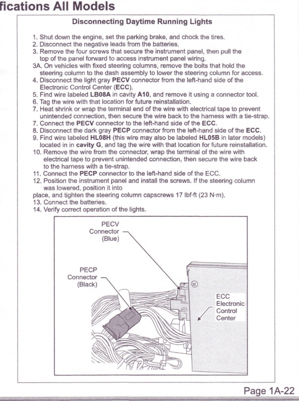

    Just wanted to post this procedure for anyone tired of their lights being on. 2013-10-28 125707.jpg

    Why disconnect ?

    Because I would rather be the one to decide whether I want them on or not. It is also next to impossible to flash a guy over if the headlights are on dim anyways. If an when the batteries go dead, it's a lot easier on the truck if you dont HAVE to haev the headlights on as soon as you push in the parking brake.
    The list is nigh on endless....
    Martin
    jason6541 and KW Cajun Thank this.

    It took me maybe 20 minutes, and was worth every single minute.
    The directions have been posted by Cetane though, and are available on here already.

    Thank you very much for putting this up, it worked on my '14 4900SB I just installed LED headlights and they were staying on drl when I shut the key off, now I don't have any drl, the way ou should be, again thank you very much, the wire for the second step was the newer number.

    will this procedurer work on 2009 ws 4900fa??
