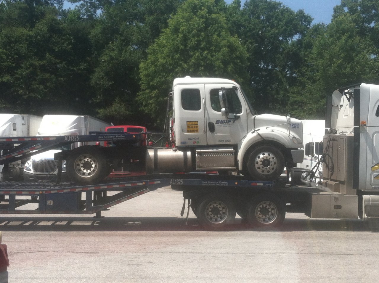

Hey cummins I found that ideal m2 setup i was telling you about a few days ago. I also didn't know swift had any in their fleet
