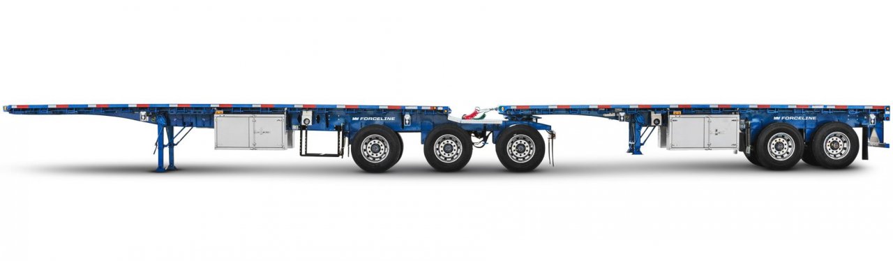

    super B is completely different
    140k gross (96k net) on 60ft of deck on 2 connected trailers
    lumber piled to the 13ft mark front to back on both if KD nav-deck-steel-b-train.jpg
    normally 32ft lead and 28ft pup
    notice: 2 48X24X24 boxes on each trailer
    18X24 cross frame dunnage rack on the lead
    not4hire Thanks this.
